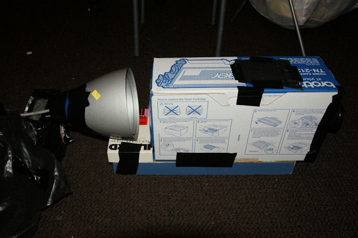

I exposed a very rough test print with the cardboard enlarger, it's just under 5x7.

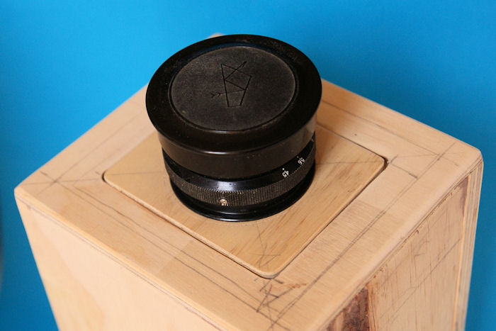

Because the lens hasn't any locking ring
I thought this may work.
Cut a hole in plywood with a tank saw
Coat the inside of the hole with resin screw in the lens
Now I hope when the resin sets it will form a thread.
Fingers crossed.

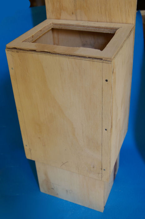

D Bogging ... will look okay after sanding
E I'm lazy shouldn't have use the on-board flash
This is the basic layout , as I have already stated not like the modern enlargers, but on the lines of what the photographic pioneers would have used. The colour stain is looking better I think I have replicated that aged look :-D
A is the lens
B the paper will go here
