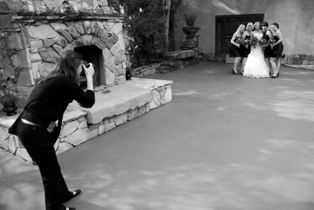

#1 - at least for the client is pretty useless.

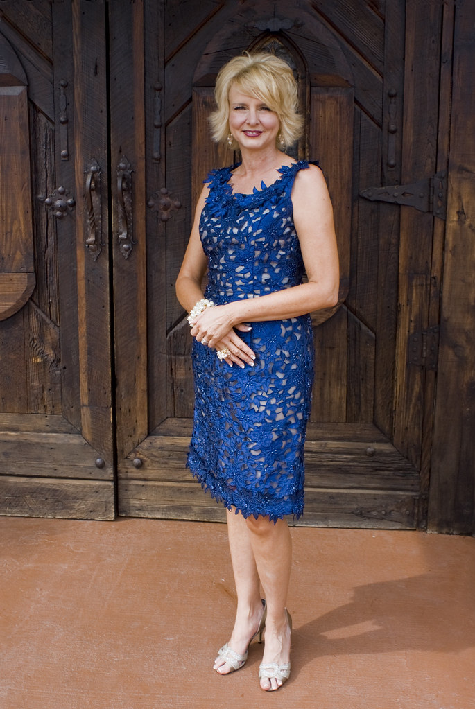

#2 - crop it tighter. There's LOTs of room on the left of the girls AND if you look at the left leg of the girl on far right (doesn't really look good) = crop it tighter.

#1 - Not sure why you post that. I do shoot my main shooter on action but usually either my main shooter is in focus, or the subject is in focus. Your photo the focus is on the fireplace.
#2 - The key to 2nd shoot while doing formal shot is to shoot it so that the subject does not look like they are posing for someone else. When I am the main shooter, there are times when I dont want the subject to look at the camera. Sometimes I ask the 2nd shooter to shoot from certain angle and I ask the subject to look at the 2nd shooter. Then the 2nd shooter will have some photos looking at the camera. But even when they are not looking at the camera, there are angles you shoot from that will look like they are not posing for someone else. When I 2nd shoot, I always tell them to never look at me. Pay attention to the main. Sometimes I shoot directly behind the main shooter so it looks like they are posing for me or just shoot it from entirely different angle.
For example, he was posing for main shooter. He is actually looking at the main shooter. I went all the way to the side of him. I think I made a decent shot and have no doubt the main shooter will use this shot.

Thanks Schwetty. Good advice as well. First shot is mainly just for context. I was sad it did not come out better but it was just a snap and not a serious shot. Did not really get much direction from my lead. Really the only reason she wanted me there was for coverage during the ceremony and the all important kiss. And the bride did have a pretty weak chin but her nose looks good! Better is a more precise choice of words.

1 - what's the point? And everything is out of focus
2 - crop
2 - crop

1. just context. Not for client.
2. not for client. Just messing around.
