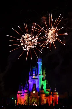

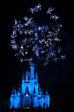

Hi. I am new here but, I thought I would chime in on this one. I agree with the tips you have already received. I recently returned from a trip to Disney World and I went prepared to make an attempt at getting some very good shots. I had a tripod, remote shutter release, and even a black card so I could try the technique of using bulb mode, and holding the black card in front of the lens between 2-3 successive bursts to get multiple exposures in one shot. I had read about using a small aperture and low ISO. I was ready. But, alas, the best laid plans often go awry. I found myself in the middle of Main Street, USA, with only my camera in hand. I couldn’t get back to the room to pick up my additional equipment and back to the park in time so, I did the best I could handheld. These shots were taken at about 1/6 second if I remember correctly. I took a deep breath, exhaled slowly, and used continuous mode when I felt the shell was about to go off. Trust me, there were a lot of shots that came out a bit blurry but, a few weren’t too bad.

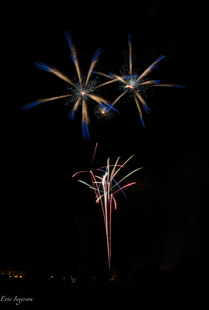

Just shot some fireworks the other day. I shot in Bulb mode. F8-13ish, ISO 100, Some recommend using hyper-focus, I actually auto focused on the first burst then locked it to manual focus. F8 and above will capture it nice and sharp. Tripod is absolutely required. I played around with shutter speed and all said and done ended up with about a 3 count. (Hear the mortar fire, press the shutter release, count to 3"ish" and release the shutter.
Kadena-11 by Ingerson Photo, on Flickr
Kadena-15 by Ingerson Photo, on Flickr
Kadena-13 by Ingerson Photo, on Flickr
Kadena-16 by Ingerson Photo, on Flickr
