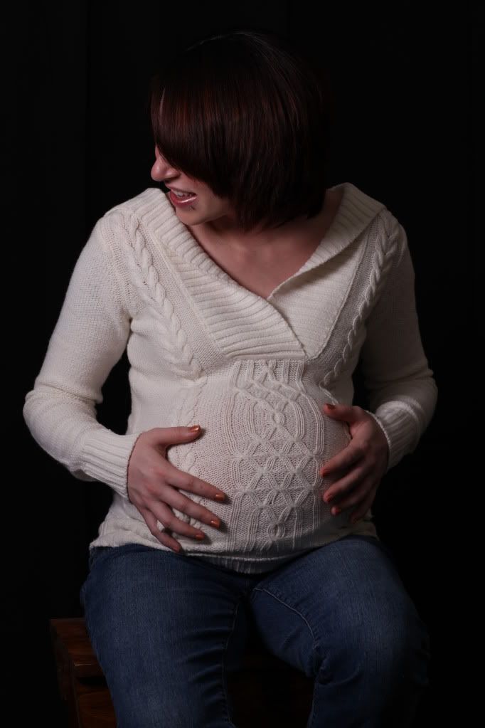

Here is my first Maternity shoot ever and the first time using my lights (Camray 3 piece lighting kit; 2 umbrellas, 1 softbox).
Let me know what you think.

They're a bit underexposed and you REALLY needed a hair light. She blends into your background in all of these. 4 is an incredibly sweet moment. 3's pretty cute too! I'd like to see that one brightened a couple of stops.

#1 will be a crop problem when you go to print at any standard size. 4, 6, & 7 might also be really tight if you have to print to 8x10. You have to leave room in the image for printing crops. Which are NOT standard to your camera's sensor size. Worst case scenario is the 8x10 in which case you lose about 2 inches off the long edge of the image.

This was just QUICK and really dirty in adobe camera raw. It's about a stop and a half underexposed.

Why does the camera have any bearing on what is wrong with the images? The camera doesn't make the decisions on how to expose the image in manual mode, you do.
It's underexposed. That comes from the settings you chose and how you chose to expose the image.
Your settings on the one I edited are ISO 250; f/5; 1/200 shutter. I am not too sure what your lighting kit is but from the name you give of it I am guessing it's a cheap light set. They aren't much power so combined with your settings that would tell me you needed to raise your ISO to about 640 to 800 to have properly exposed the image.

I read through the entire thread before commenting, especially since any type of portrait work is not what I do. So after reading the entire thread I went back and studied the photographs. In picture #1 her hair does in fact blend right into the background. So the suggestion of a hair light, or maybe using a different background color would work. In picture #3 she looks under exposed compared to the previous pictures, and in picture #4, the boy friend is under exposed more then she is. As for the hand imprints, that would be a subjective call by the clients.

I do think for a first time and in studio with only a black backdrop? They are really pretty well done overall. You have great basic images to work with, you just need to adjust your curves and exposure a bit. They are clean, clear and crisp. Could they have been better? Sure, but they are not bad by any means. You'll improve in every session you do.

How did you get the black background
Black Muslin Backdrop, lower exposure. Too high of an exposure and I could see too much of the backdrop (folds, bright color, etc). I didn't want that.
