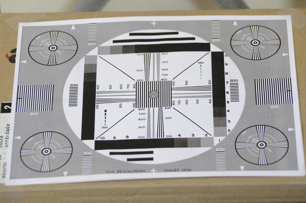

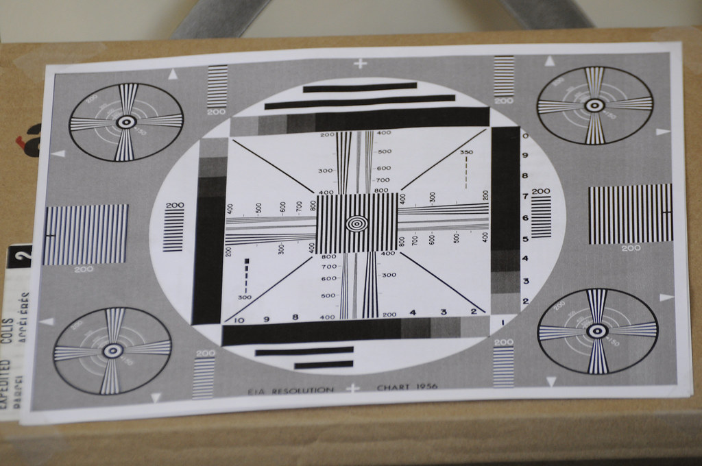

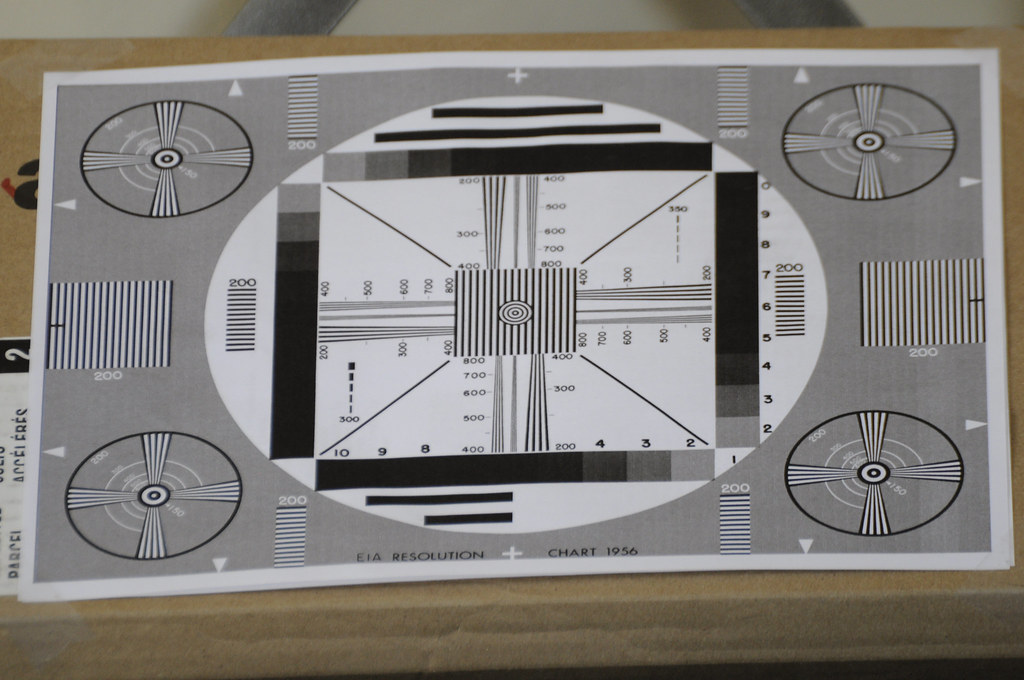

Downloaded the 1956 Chart and did what I could for a 45 degree shot, indoors. Used a tripod at ISO 800 / F5.6. It's still windy out.
I don't really know how to do this properly.
100mm
200mm
300mm
