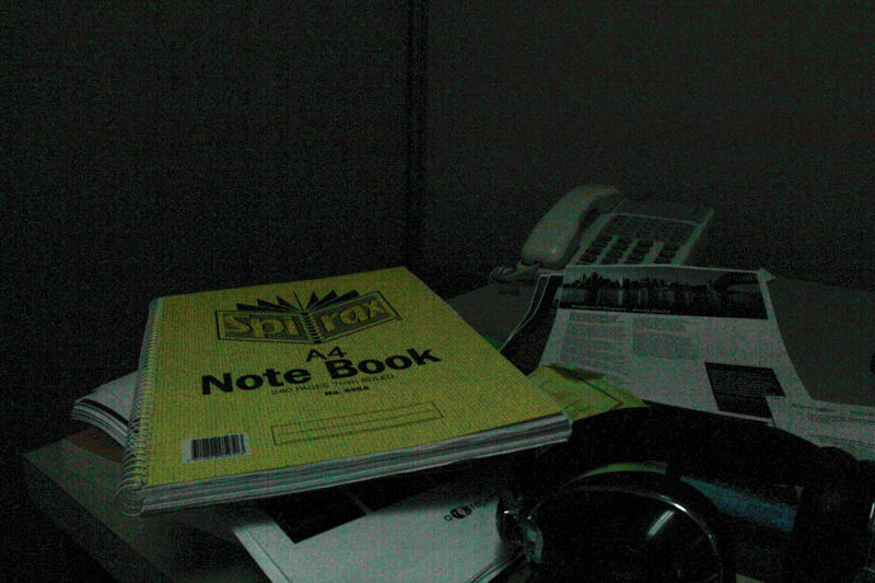

I am quite new to photography and I was doing some lessons/challenges. I am trying to move onto manual shooting. I started with Sunny 16 which is meant to be a basic exposure. However I get a black screen. As my camera focuses everything is looking ok, then as soon as it focuses bam, black. The exposure reads at -3 so that is obviously not good as it is meant to be 0 I believe.
1/125
F16
ISO 100
Flash exposure 0
image effect Auto and tried Neutral
White balance Daylight (5200k)
Auto correct image brightness off
metering mode (tried all centre weight average, spot metering evaluative)
Cannon 600D
EFS 18-200mm
The EXIF data does confirm that you really did use those settings:
  • Exposure Time (1 / Shutter Speed) = 1/125 second ===> 0.008 second
  • Lens F-Number / F-Stop = 16/1 ===> ƒ/16
  • Exposure Program = manual control (1)
  • ISO Speed Ratings = 100
Were you, in fact, taking a photo of a subject outdoors in noon-day sunlight -- full sun?
Did you remove the lens cap?
The sunny-16 rule works extremely well. The sun is very consistent. The rule has nuances for light, moderate, and heavy overcast conditions (or light/moderate/heavy shade conditions). Early morning or late evening sun will be different than mid-day sun. But this image is completely black -- even if it had been a heavily overcast day, you'd see a very under-exposed result but it wouldn't be completely black. Hence... my question about whether the lens cap was removed.

Yeah well it isn't a perfectly sunny day, I mean it is a little overcast but surely it wouldn't be entirely black.
Yeah I don't own a lens cap so that is impossible, it fell off a year ago in Vietnam into the ocean, also I am not a bumbling idiot (despite losing my lens cap, I swear it was my brothers fault) but I am sure you get many on here so I won't take offense to it. I tried many different settings and it works perfect when I use other modes. The photos are fine in Auto/landscape etc so not a lens issue.

Well, you did try using Sunny 16 indoors... I don't mean to be snarky, but seriously - the room is mostly shaded by the walls and roof.
I fixed it I changed the white balance (increased) and the auto correct image brightness and I can see a feint outline now of the building.
Thanks everyone I still have not mastered manual photography (obviously). I was under the impression that sunny 16 would give you an exposure of 0 I didn't think that a bit of clouds could effect it so much. Tomorrow is meant to be sunny so hopefully I can test it out again.
That brings up a question though. Why does artificial light not work, I tried it in my office before going down stairs. Does the type of light matter?
ANYWAY - spot meter off the wall and increase exposure to +1.6-2.0, provided they are painted white.
The meter is calibrated to middle grey, one important thing to realize is that zero does not mean "correct exposure" it means "similar value as calibrated". By increasing exposure to one and two thirds above how the meter was calibrated you're basically using the walls as a reference for everything else. It doesn't matter what that reference is, so long as the exposure is compensated to represent how much more or less light than the standard calibrated value is allowed to accumulate onto the sensor.
It sounds SUPER complicated, but give it a try. Expose the walls dialed in at "zero" and again at +1.6. Notice how the walls appear grey and everything darker than the walls (i.e. most of the room) will appear far too dark. At +1.6, things will look more like how they should.

Artificial light is far more dim than sunlight. We don't notice it because our eyes compensate for this both in terms of iris (f-ratio) and through "post processing" in the brain.

This is just a testament to how sensitive our eyes are. But without any compensation, even our eyes wouldn't work well. Have you ever had your eyes dilated at the eye doctor? Not only does it hurt, but also appears way over saturated. This is because the signal presented is far higher than what can be compensated for by the brain. In a sense, it clips in the same way, though more elegantly than a DSLR might.

Your image isn't black, it's just grossly underexposed. Probably close to 5 stops underexposed. I had to max out the curves just to get this much out of it.
The Sunny 16 rule ONLY applies in direct sunlight. It has NOTHING to do with indoor shooting and will not give a proper exposure, as your shot shows.
