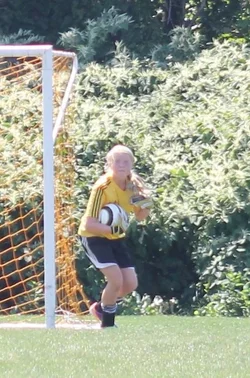

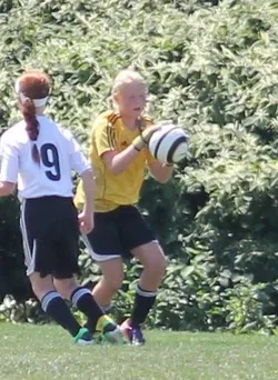

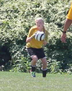

The 1st 3 are of my daughter and out of focus. The last 2 are better pics.

Hi, ropeman. Thanks you for posting some pictures. Unfortunately, the EXIF does not contain the exposure data. Will you please post the EXIF for one or more of these shots, please? Include the lens, ISO, shutter, and aperture.
BTW: do you have any filters attached, such as a UV filter?
these almost look digitally zoomed on a pns camera.
The first batch simply looks out of focus, in which case you need to learn techniques for sharp focus. I'd need more information about the other images.
Seeing the pictures now, these don't look like camera movement or shutter blur, but look like exposure and/or focus problems. See what your meter is indicating when you're shooting in bright sunlight, looks like your camera was getting too much light for those first three, maybe the aperture needs to be smaller.
Even if you want lots of pictures if you take time to think about your camera settings and adjust during the game as the light might be changing and as the players move around, that could help you get better pictures.
The Canon 70 to 300 zoom is not particularly sharp and if you are heavily cropping and/or shooting outside the sweet spot of the lens, that will only exasperate the problem.
The pics are cropped. Some r only shot woth the 70 lens not really zoomed out. Like I said I am a full soccer field away from my daughter so I need to work on zooming out to 300 and focusing better. I usually dont have a lot of time to react. I will work on it
