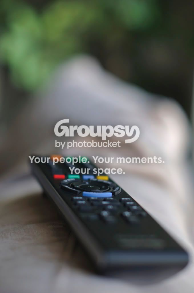

I took this shot of my remote on the back of the couch. I shot this with a 50mm at f/1.4, with the focal point placed on the round center button. You can see how the focal plane is pretty darn thin, and this was me fairly darn close to the remote. If I was trying to focus on a small subject and it, or I moved; it would throw the shot off and I would have a soft subject.
When you zoom, you amplify this.
So you see, it doesn't matter how fast your shutter speed is if you don't have your aperture right for the subject at hand, or the intended look of your photo.
For your shot above, I would take your aperture and put it around f/16 and then focus slightly in front of your subject (geese) and you'll have a nice sharp image. Don't forget to keep your shutter speed number equal to or higher then your focal length to help with the motion blur of a hand held shot.
