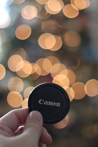

So for Christmas Santa brought me the 50mm f/1.8 Canon lens that I've been wanting. I played around with it and was excited to see real Christmas light bokeh - until I uploaded them to my computer. My bokeh circles have little weird squiggles or imperfections in them, and I'm concerned there is something wrong with the lens.
bokeh by picnicknits, on Flickr

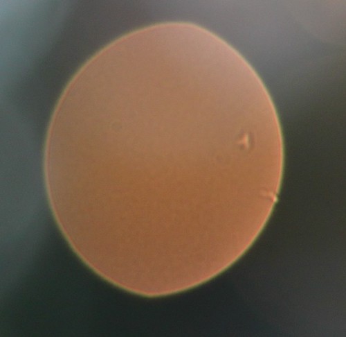

This is close-up of one of the circles. It seems to be in every circle, but not in exactly the same spot. I put on my kit lens and got some smaller bokeh with that with no squiggles, so I'm assuming it's the new lens.

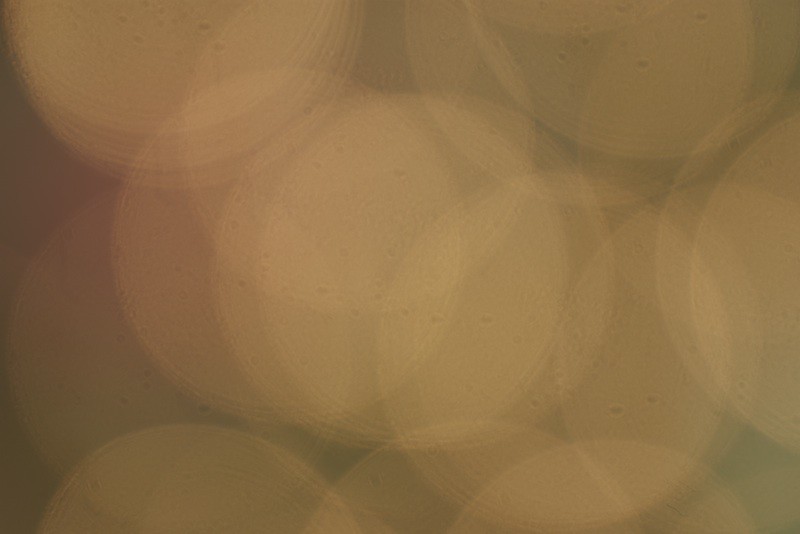

I took a test with a lens that I have with three specks of dust on the internal elements. I found that the flaw is replicated across the bokeh field, and not in a specific place, as it is here.
You wil find here as in your example that there are repeating patterns throughout. This wouldn't be the case if it was just ordinary dust. I also cleaned my sensor (finally) and did the same test with a clean lens, and did not find this same pattern.
However, in my test the anomalies are dark, yet on yours the anomolies are light, which says to me that they are focussing light. I am guessing this would suggest that it's liquid, perhaps oil or maybe (and less likely) bubbles in the glass. My thinking is that your new lens is, unfortunately, defective. You could try using an alcohol swab on the front and rear elements and see if that helps, but my guess is that you have two drops of oil on one internal element and that you'll need to call Santa's customer service desk for a replacement.
