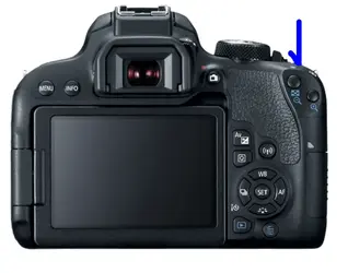

I’m trying to set my 2000D up for “back button focus” and both the docs for the 2000D and T7 that I can find online refer to the * button, but I can’t find it. Is it like the “any button” on a computer keyboard? If anyone is familiar with setting up “back button focusing” on this model, help would be greatly appreciated. TIA!

From memory but I believe on the back, in the upper right corner are two button next to one another and the one on the left is the '*' button. I think it is normally used for exposure locking?
Is it this one?
Thank you! That’s it! I have no idea how I missed it. Tired eyes or something.
