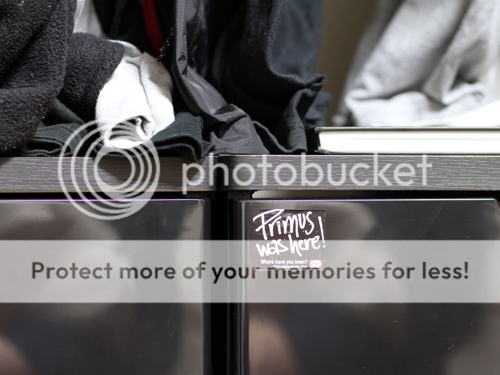

UPDATE: In the interest of a fair review, I am posting 3 pics that display the beautiful bokeh this lens creates. I want everyone to understand that this is an outstanding lens despite its flaws(which are numerous).
These were all shot wide open handheld. I was able to(and required to) use extremely fast shutter speeds due to the large aperture.
1/8000th sec
1/8000th sec
1/4000th sec
