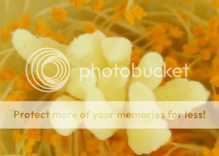

i am getting the microscope adapter, its been shipped already. i got the microscope end of things i need, or ordered. what i am trying to show is this.
with my scope on lowest magnification (40x) and no camera magnification i get this close...or can go closer.

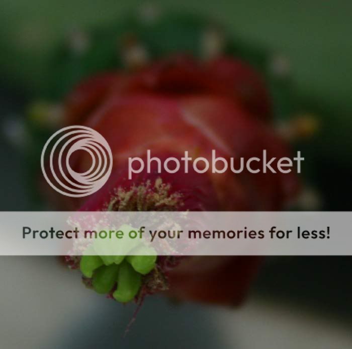

with my current lenses i can expect this kind of distance
http://i159.photobucket.com/albums/t153/plantsss/flower8.jpg
what i want is something in between these 2 or even closer to the flower size but better quality.

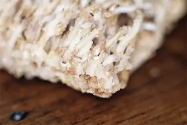

I am not sure if I explained myself well in my post, so I am going to demonstrate.
This is done with a M42 bellows (Asahi Optical), 135mm lens (Sears Auto $20), and a ring flash macro ($40). The camera is a Samsung GX-1L (Pentax iST rebrand) DSLR.. fairly outdated.. 6mp (purchased at pawn shop for around $200). Nothing fancy nor expensive. Really, the camera itself is not important. The lens is fairly low quality and old..
The first attached photo was done with less than optimal lighting, shot with the lens wide open. I brightened it up a bit post in photoshop. Notice the IQ, lack of sharpness, and shallow DOF is similar aspects to your samples.
The second attached photo was done with the ring light with the lens at f/11 which is properly exposed.
Notice the difference in the image quality and detail captured? I'm not saying to go out and duplicate my "budget" setup but to examine the process used to create the photos.
Again.. something to try before blowing more cash on expensive equipment... you just might stay well into your budget.
