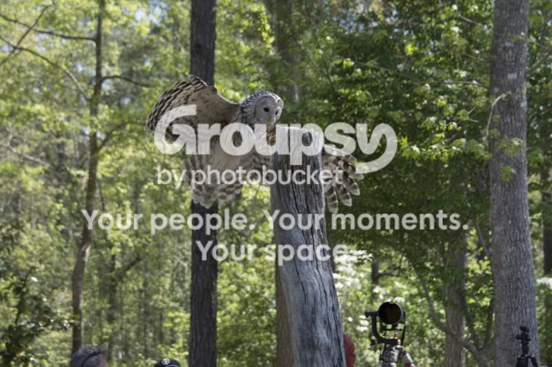

Remember, you may want to have a small amount of motion blur to convey motion. Every subject is different. For instance,b with people walking/running you may want to find the sweet spot SS that always a crisp body but leaves some motion in the feet/legs and/or arms/hands.
awww that last one is at 1/100 at ISO 100. Try ISO 800 and boost that shutter speed up, see how that goes.

1/100sec is far too slow - 1/500sec at the very least is what you want. Note that with wildlife I'd treat ISO 400 as you base ISO to start with.
In the first one the wing tips were moving faster than the rest of the bird, so you needed a faster shutter speed to stop the wing tips.

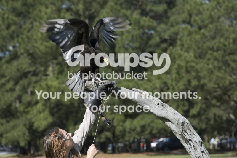

In #2 1/100 was also insufficient shutter speed.
