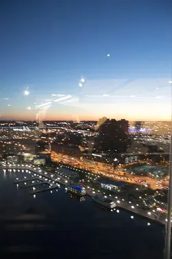

I took some pictures from an observation deck and found that I was getting reflections from both my self and the interior lights. would a circular polarizer work to get rid of the reflections? If so, any suggestions on a good one that won't break my bank account?

Likely it would, yes, but the degree of effect will depend greatly on the sun's angle and position relative to your shooting location.
Polarizers work really well when the glass is at a 45º angle getting reflections. If the light source is coming from nearly directly "behind" you then the adjusting the polarizer may not do much to help (but you can always change how you stand so that the polarizer can work more effectively.)
Keep in mind that the polarizer will "reduce" the reflection (possibly quite substantially) but may not necessarily eliminate 100% of the reflection.
If you can stop light reaching the glass from your side in-front of the camera (in the view of the lens) then you wont have reflections. Just get close to the glass & use something (hat, coat, dark cloth...) to block the light causing the reflections. Usually much more effective than a CPL :)
Where you can't get close to the reflecting surfaces (perhaps they're part of the subject) a CPL used correctly can be a great help.

Putting the lens, with a lens hood on it, right up against the glass works too.
Yes that works fine, if the angle of view allows it & if the glass is free of vibrations (not vehicle windows).
If your using a rubber lens hood you can often pretty much ignore my provisos.
I think your problem is from direct reflection off of the glass.
And a CPL doesn't filter out direct reflection.

All light that does not come from a laser is unpolarised. That list above of polarised light covers all light - emitted, scattered, reflected or refracted - and is essentially meaningless. The light sources in the observation room the OP mentioned will be unpolarised and the reflections from the glass will be polarised and so the cpl will remove the reflection if used correctly.
