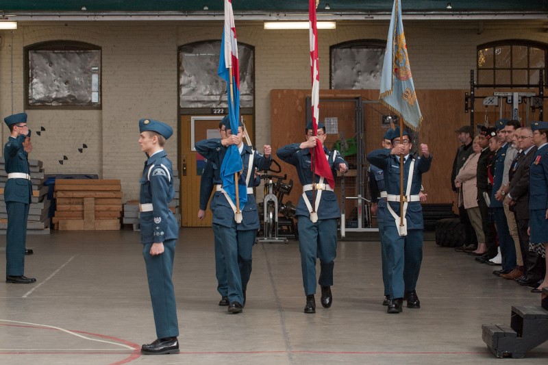

You're going to need a LOT of those lights to do anything useful. I'm not knowledgable enough on LEDs to figure out exactly what 192 watts of LED equals in terms of incandescent, but it's not going to come close to what you need. Strobes are the way to go. Last year I had a job shooting a military parade in this venue:
The ceilings are 40' (or near enough) at the peak, and the floor space is something in the order of 30,000 sq ft. I used 5 or 6 Speedotron Brownline M11 heads with 400 w/s going to each head, for a total of 2,400 w/s. This gave me 1/250, f5.6, ISO 640 +/- 1/2 stop over the whole floor. I bounced the lights off of the ceiling and it worked very well. I had the advantage of a domed, light ceiling which made for good light spread, and granted it wasn't the most exciting light, but it worked well overall:
and with some minor tweaks to the highlight & shadow sliders the end result pleased everyone.

That looks amazing. I will do some strobe research

Yep... all the lighting I used to light the armoury shown above will cost <$500 on eBay.
