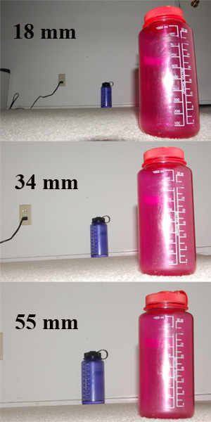

Yes, I agree.. 85 or longer is best for portraiture. Does not matter if it is cropped or not. See these samples.
http://www.holesinthenet.co.il/wp-content/uploads/2011/11/image31.png

You are correct, however, for portraiture, camera-to-subject distance plays a critical role in many aspects of the process. The example you linked to varied camera-to-subject distance along with focal length, producing the distortion. As your example clearly shows, camera-to-subject distance powerfully influences perspective distortion. Also, adequate personal space while still allowing comfortable communication impacts the portrait in a qualitative or even subjective manner. Classic portrait focal lengths are essentially those that produce the most flattering images while utilizing a reasonable amount of studio space.These aspects translate reasonably well when applying a crop factor adjustment to a shorter lens. The ability to blur backgrounds with narrow depth of field is lost to a notable extent when shooting with a shorter focal length lens on a crop sensor body.

I think you are incorrect. As I understand, the distortion is inherent to the camera-to-subject distance, not the focal length of the lens.
I am with Tyler. Doesnt matter... 28mm will distort your subject unless of course you only put them in 10% the size of the frame and maybe you wont really notice it. Full body shot will take most of the frame. You will get distortion.
We're losing track of the issue. 50mm on a 1.5x crop body has the same FoV as 75mm on full frame. Put a 50mm on a crop body and a 75mm on a full frame. USing each set up, compose identical photos (framing-wise). DoF aside and all else otherwise equal, the photos will be identical in terms of perspective distortion, because the camera-to-subject distance is identical. The example you linked to essentially proves my point, as it illustrates how changing FoV requires changing the camera-to-subject distance to achieve the same composition (again, framing-wise).
http://en.wikipedia.org/wiki/Perspective_distortion_(photography)
Nope... You really think the red bottle looks the same??
