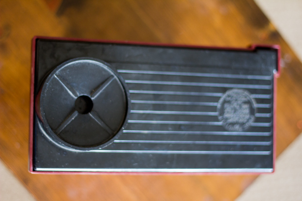

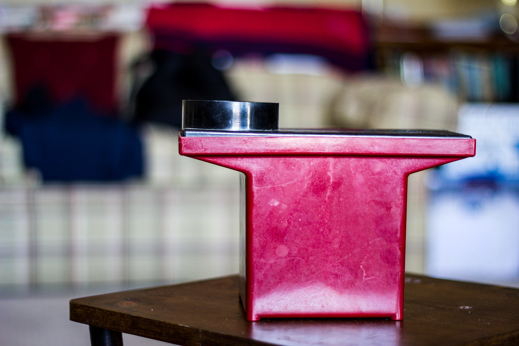

Here's a photo of the developing tank:
IMG_8705.jpg by tsmcdona, on Flickr
IMG_8706.jpg by tsmcdona, on Flickr
Thank you all in advance!
The struggle with daylight sheet tanks is getting even development. Most of the designs try and stuff too many sheets in the tank at once and the development flow between the sheets isn't adequate -- the negative (pun) result of this is over developed edges. Daylight inversion tanks help with this but it looks like yours won't invert. So how many sheets does the tank hold? Consider dividing that by two and leaving every other slot blank and then make sure you agitate well.
I solved this problem by using daylight tanks in the dark. I got everything ready to go. Poured the developer into the tank in the light with the lid on and then turned off the lights and took off the lid. With latex gloves on!!! I agitated the film by lifting the holder up and down in the developer and lifting the holder completely out of the tank each cycle. DON'T TIP THE HOLDER AND DUMP THE FILM!!! When the development time was up I replaced the lid and turned on the lights and proceeded with the process.
Joe

Hey Tyler,
Joe just gave you probably the best solution.
The way the tank is supposed to work is, you pour the chemicals in through the large hole and pour it out using the odd shaped corner. I've gotten good results using all the hangers, but only loading every other one, using the empty hangers as a spacer. These tanks aren't invertible. I used to have a small piece of Plexiglas rod that I set down under the middle of the tank so I could rock the tank back and forth for agitation. You'll want to premeasure how much fluid to use so you don't over or under fill the tank. You'll also want to give the tank a sharp rap or two to dislodge any air bulbs. Hold onto the lid as you do this so you don't jar the lid off.
