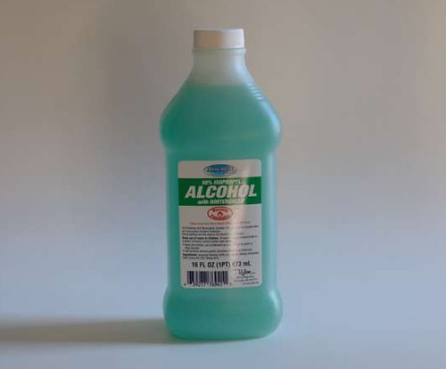

The other day, I was cleaning out a scraped knee of one of the children, and took a close look at the bottle of rubbing alcohol I was using. (Yeah, I could use peroxide, but alcohol stings more, and I'm an evil bastard.) I noticed two things... the shape of the bottle, and the shape of the base.

Step 1. Buy a bottle of rubbing alcohol at the dollar store. (or steal it rom your wife. That's what I did.)
Step 2. Dump cheap alcohol....... . (this would be a good time to remove the label too...)
Step 3. Draw a line around the bottle about three inches from the bottom, and cut the bottle into two sections. You can go ahead and throw out the top section.

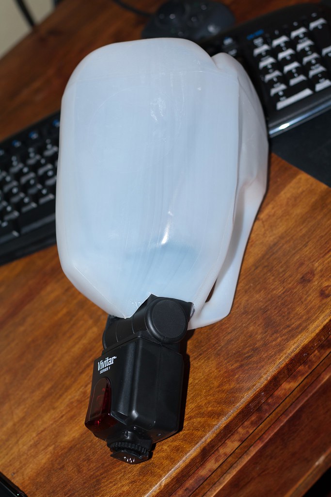

Step 4. determine how you are going to mount your modifier.

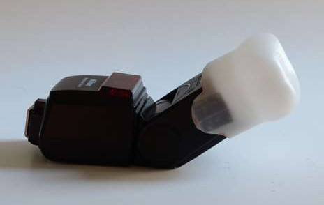

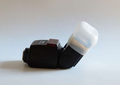

Two ways of doing this. The first is to attempt to make it look like a store bought unit.... or as close to one as possible. This would entail trimming away plastic to make two mounting tabs on the short sides of the "modifier" (as shown in the picture). Put velcro on both the speedlight and the tabs. This will not only make you look like a pro, it will also make a very satisfying sound when removing the modifier.
The second is for those that either don't have velcro strips, or don't care that people will be talking trash behind your back while you are takind photos..... Don't bother trimming any more of the sides of the bottle. Take a thich rubber band, and wrap it around the very top of the speedlight two or three times. This will make a nice rubber bumber that will pressure fit the "modifier" and keep it in place when in use..... Like so.
