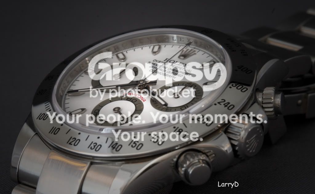

I've done a fair amout of watch photography, and the 100mm Canon Macro doesn't need any help to get in close.. that's what it was designed for.
You could probably crop a decent close-up with that lens to see the legs on any bug
That's a fantastic shot of your watch, Larry. I'll try to take a few with my 100mm and see what I come up with. Thanks for sharing your photos. It gives me hope!
