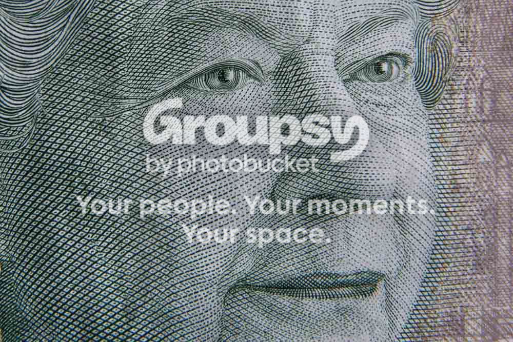

This was took using a 12mm tube and a Canon 350D with an 18-55mm lens...

I've taken a macro of a letter on a dollar bill. DOF was so thin, I had to focus stack it.
Thank yall for the replys, I'm definitely a macro newbie so any & all advise is welcome! Edsport that photo is beautiful! :)

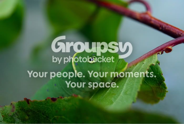

That shot of the dragon fly is a single shot and handheld. As soon as i took the photo he flew away. Here's a couple more single shots with the same setup...
