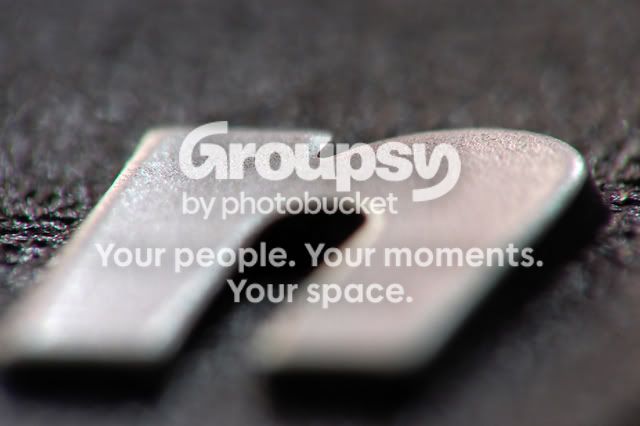

I just bought 52mm lens coupling ring and I decided to try some extreme macro shoots.
I installed my 55-200mm vr on camera (zoomed it to 200mm) and I put my 50mm fully open (f/1.8) reversed.
It is pretty difficult to get sharp image, DOF is extremally narrow but take a look:
This is Nikon lens cap (52mm)

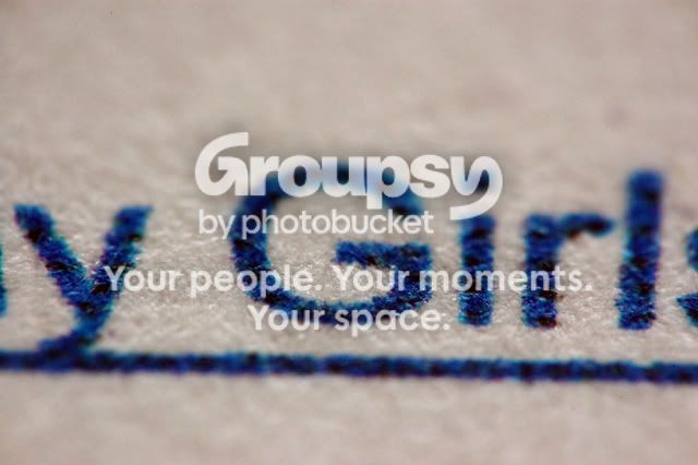

And this is print - font no10
I was quite impressed whan I saw it on computer

WOW.
Tiny shooting. Looks fun.
Just don't say they were hand held. :confused:
They were. :D I used built in flash.
I was focusing by moving from and to the subject. You need to get really close with this lenses.
