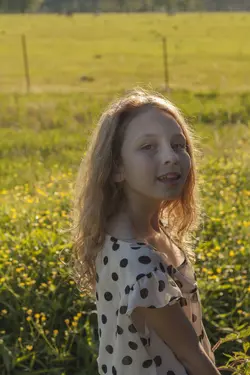

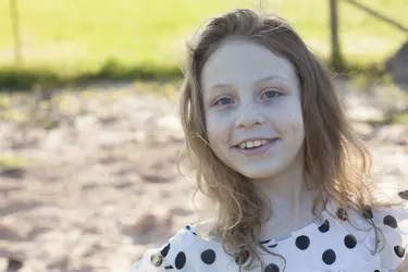

here is two more

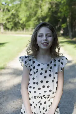

i have the raw files...everything was shot raw. Im sure it is my overriding. Can PSD files be posted on here?
the color being way off...is it more of a white balance thing?
i opened the raw file for image 4. I opened it up in camera raw filter and left the WB "AS SHOT". Does the coloring look better?
aside from the darkness in her face and the shadows.........
