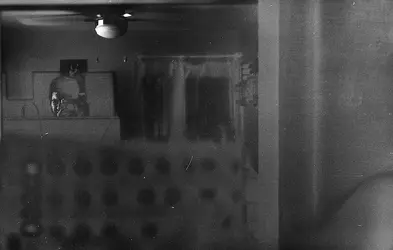

First timer B&W developing issue - Thin Negatives?
illegalfilm
Sep 21, 2021
Metallic, cloudy look, exaggerated shadows etc
What is happening with my scans?
What im using:
Canon Canonet TMAX 100 B&W non-expired
Cinestill Df96 Developer & Fix
Epson V330 Scanner
Agfa Rondix 35 Daylight Developing tank
Process:
Get chemical temp to 80 deg. (recommended by cinestill df96)
Pour in df96 into tank and roll film all the way back and forth continuously for 3 min
Pour out chemical and immediately pour tap water into tank to flush out chemical a few times
then i take the tank cover off and rinse more with tap water
Pull film out and hang to dry
I also did notice the film negatives do have a purple ish tint as well, if that means anything
