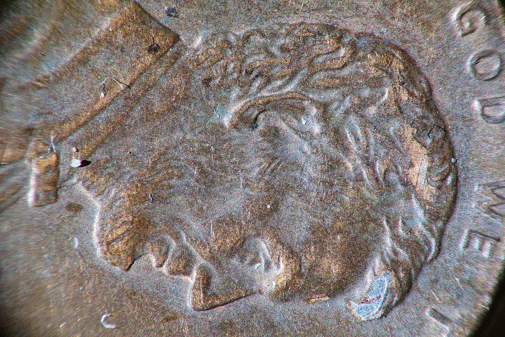

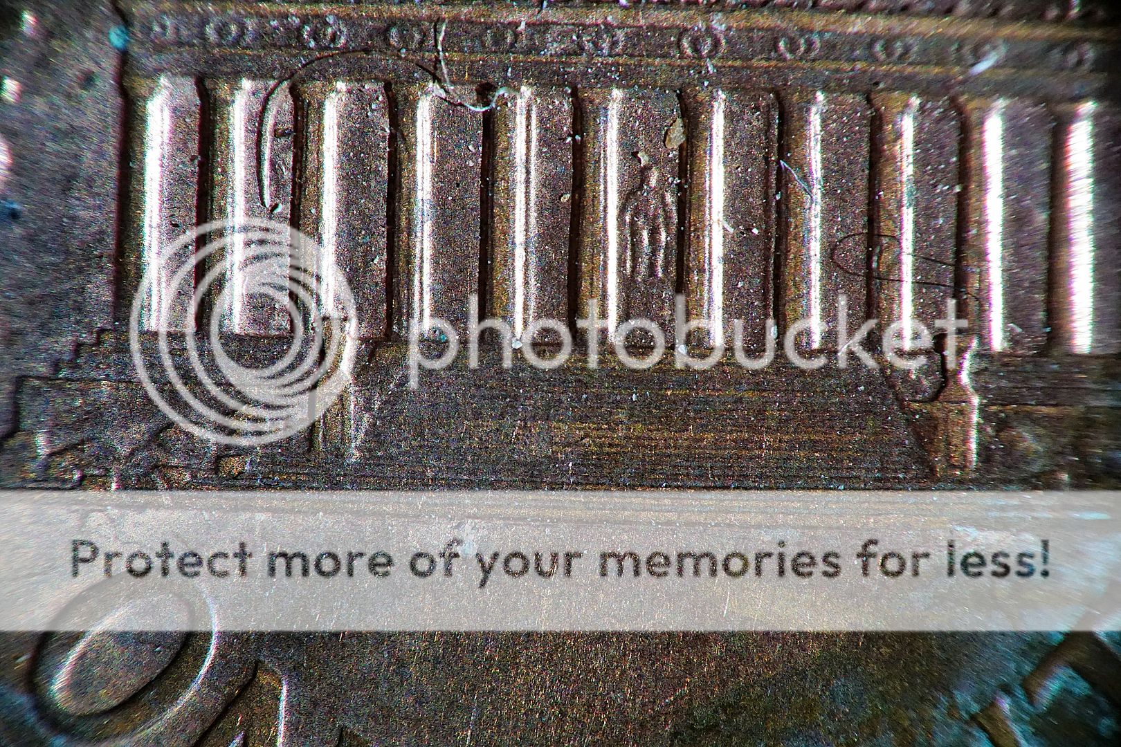

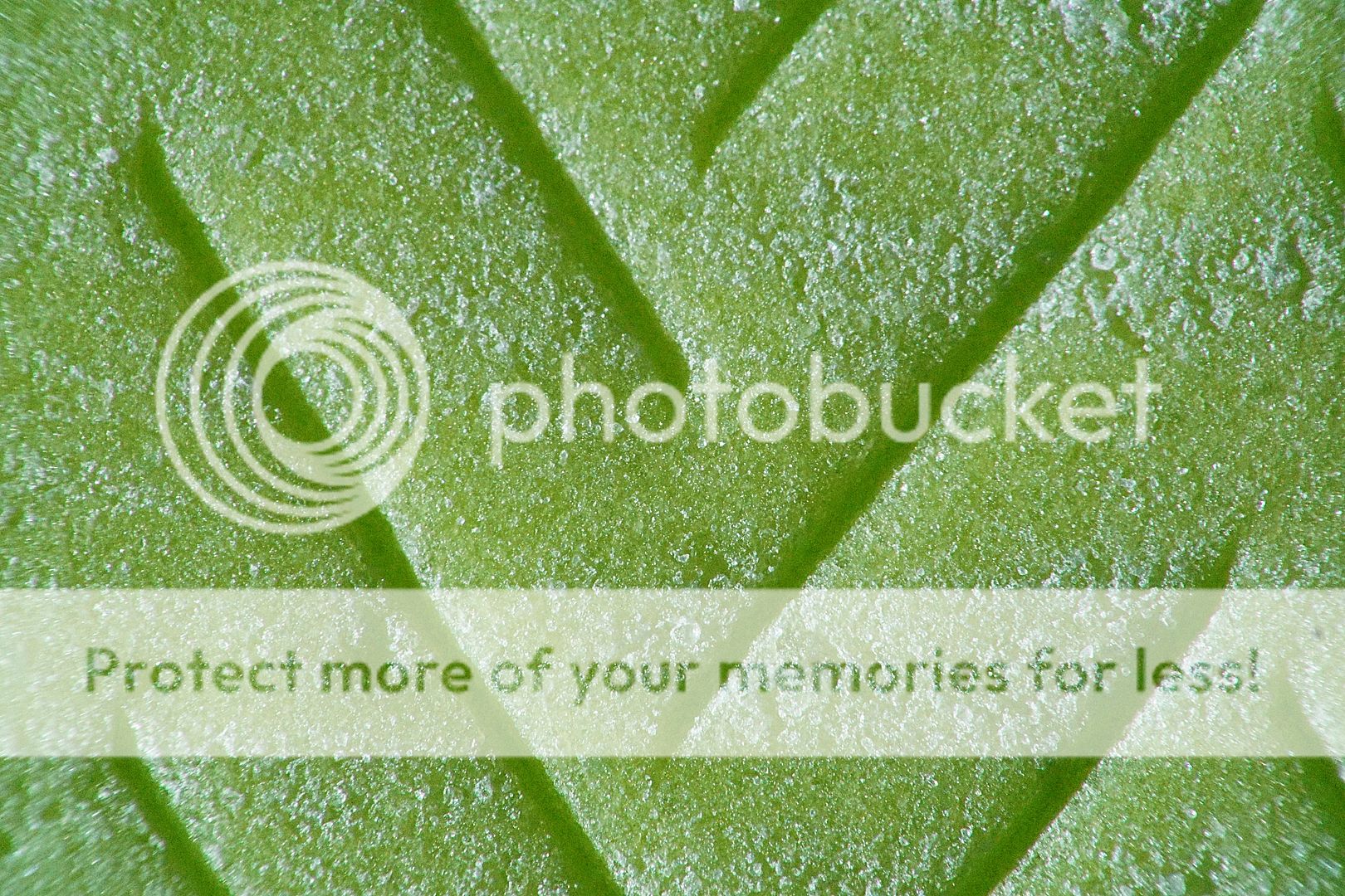

Finally got around to trying some "true" macro shots, but I don't have a macro lens or tubes, so I did it the poor man's way ;-)
These are actual size, no cropping or anything.

I used a Rokkor 135/2.8 as the primary and a Rokkor 50/1.2 as the secondary, giving me a magnification of about 2.7.
I did try a 28mm as the secondary , but it blacked out the corners, leaving just a circle in the middle.
That's cool. Did it distort the image as well or just end up with a round image?
No distortion really, just a circle "crop". It's the limit of the secondary lens aperture, that is what was cutting off the image
Ahh, makes sense.
I need to correct myself. Actually it is the secondary lens's ability to show the position of the primary lens aperture. So a wide secondary requires a "wide" aperture in the primary, otherwise it cuts off the image. The issue is that a wide aperture in the primary degrades detail.
I tried a few more test shots. A 40mm secondary gave me a magnification of 3.3x
I also re-tried the 28mm, and setting the primary at wide open yielded a full image, but at 4.8x magnification I could not focus the image. The floor that the tripod is resting on moves to much!
Here is Lincoln at 3.3x
