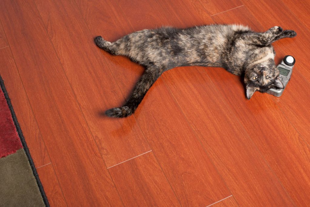

I was playing with a new light modifier last night with a meter. I suggest the Sekonic 358.
And my girl Jersey last night proved no matter what the light meter said at different settings, the Octabox makes some soft light =)
Pic of meter:
