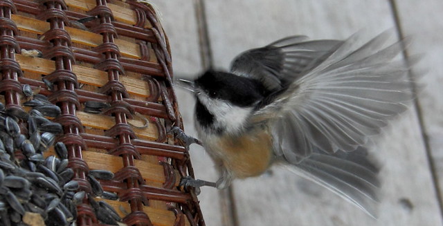

I've been using the chickadees for practice trying to freeze motion with flash.
It seems rather inconsistent. and I'm wondering if I'm expecting too much and they are simply a smidge too fast for the on camera flash and max shutter speed of 1/250.
If a chickadee is sitting on the railing and I flash him they often take off and he will be wings spread and awesome (but often a wee bit smudged/ blurred like in this shot), on the other hand, do the same to a blue jay and he looks totally awkward in the moment before he spreads his wings but sharper focus (bigger/slower bird)
Am I on track thinking this way, I'm pushing the limits of using this method with my on camera flash or am I possibly missing something?

In the first shot my settings were:
1/250 F8 1000 and a flash exposure comp of -1 (should have just dropped my ISO)
I had played around with flash exposure comps of up to -3 that time shooting.
