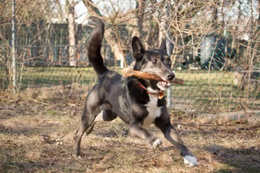

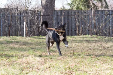

Could you show us a few results? 1/1000sec should get a sharp shot in many situations.Sometimes seeing a few results can give us a quicker idea of what might be going wrong or what you might work on to get things to work.

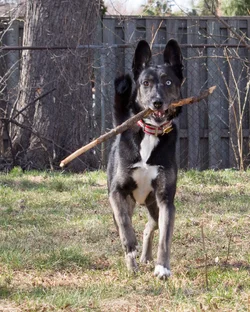

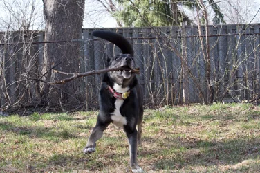

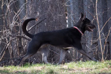

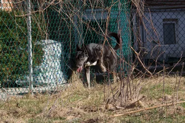

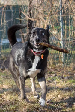

These are varied-played with the ISO a bit but I find since she's all black anything at 800 is just slightly too noisy and annoying. Different lighting conditions, days, etc, obviously.

Exposure looks generally good as does focus. The one, 8640, looks like the focus point is a couple feet too close to the camera.
I would have do do a face shot of this puppy. Great eyes
You are sooooo close on a number of these! This shot Freeze Motion - Slow Lens and Flash Photography Forum is pretty good, but the depth of field is just a bit shallow to get full focus...a significantly slower shutter speed + second curtain flash, right on-camera, in the hotshoe, could be pretty good here...the ISO needs to be "high-ish", and the speed needs to be "slow", like 1/8 to 1/20 second or so.
Panning is a great way to convey movement, and one of the very few times where I will actually FAVOR shutter priority, Tv or Time value as Canon calls it, to keep the speed at the right level. You could try that approach, slow-speed panning with second-curtain synch.
The other DOF issue/tip is to shoot at right-angles to the dog, perhaps easier said than done, but maybe if you give the dog a triangle-shaped course, he'll tend to run in a line for one leg of it?
The other option is getting the ISO level UP, high...after work, this time of year, it gets dark pretty fast until July and August roll around. With a longer lens that tops out at f/5.6, at ISO 500 you8 mighty be as slow as 1/50 second in many yards...I was out today, and was getting f/5.6 at 1/50 in the shade here around 4:45 PM.
As others have noted, it looks more like missed focus or too-small DOF.
I think I'd start out looking at the DOF for each shot. Check the EXIF information for each photo for focal length and aperture, and focus distance information. Plug that into the DOF calculator Online Depth of Field Calculator and see if you are getting at least 3 feet DOF to get the whole dog in focus.
I'd also restrict how many AF points your camera can choose from (menu settings). Unless you are fully aware of how the camera decides which of many AF points to focus at, you'll find that too often it chooses the wrong one...usually whatever is closest.
And, I'd also think about setting the metering to center-weighted. I've found it usually gives the best results when in aperture- or shutter-priority modes.
I know that I'm missing focus-my question is how to I get there so that I DO get focus, or just have a higher probability of getting focus on more of these shots? It's comforting to know you think I'm close on some of these-I feel like they're just so far away :(

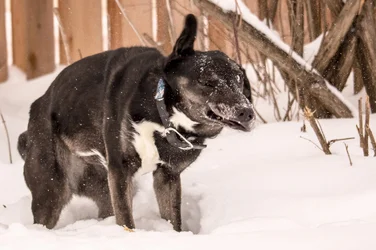

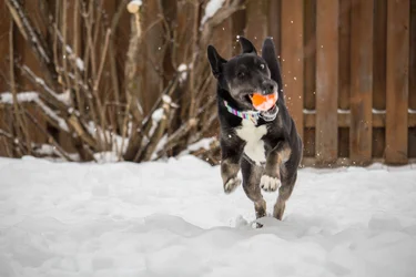

C. Brian Kerr-just for you, I've attached one of my faves of her. The 'catch lights' from the snow are a bit annoying but I love it anyways :)
