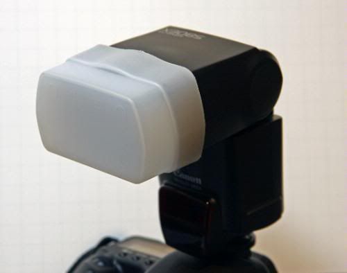

If you are using one of these:
Don't use it outdoors.
The way they work is to spread the light out, so that instead of a directed beam of light coming from the flash (like you'd find in a flashlight), you get light going in all directions, like a bare lightbulb. If you are indoors, it works okay because there's usually a wall or a ceiling that the light can bounce off, which helps to fill in some of the shadows. But if you are outdoors, there are no walls, and you are just sending light off in directions where it won't work for you. This wasting of light means that you have to increase power to your flash to get the proper exposure, and you just waste your flash batteries.
To get softer light, you need to make the light source LOOK larger. A softbox or an umbrella is a good way to do this. If you have a friend with a reflector, you can bounce the flash off that.
