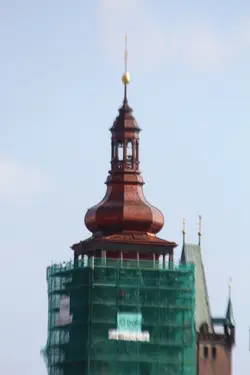

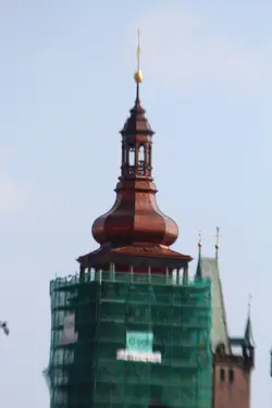

Heloo, I would like to ask you for advice. Here are few pics that I shot with my Canon EOS 600D (Canon EOS Rebel T3i) and with Canon EF-S 55-250mm f/4-5.6 IS II lense. I don't think this is normal. It's toooo blurry. It drives me crazy :angry:. Do you have any idea what could possibly cause this thing?

Very,very VERY weird image rendering. The center is sharp, but the edges are utterly HORRIBLE!!!! My first thought was that the lens might have been dropped or banged hard. Second thought is that maybe the rear element is greasy or hazed over at the edges, but clean in the center; sometimes, certain fabrics or foams can out-gas, and deposit a film on lenses. Third thought was that the image stabilizer function is over-reacting or in a feedback loop. Fourth thought was cheap-o polarizing filter.
Looks like the camera rotated a little. Something caused that gold globe to crawl up the right side of the pole on top!

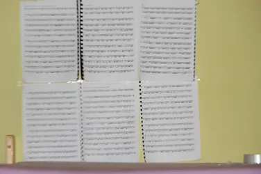

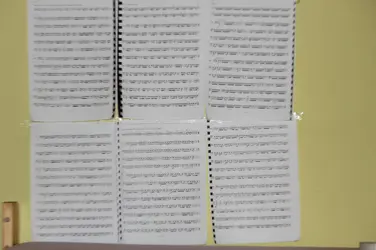

Tape some newspaper to a wall at the other end of a room, put the camera on a table and shoot across the room. See what you get.

also tried the wall thing:
this one is shot with timer on table:

Very weird. Turn off the IS completely. Turn AF off. Take off any filters. Put your camera on a tripod. Focus manually, using Live-view at 10x. Shoot a series with Maximum aperture (f/4 in your case), then at f/11, then at F/32. Do the same across the zoom range (say, 55mm, 135mm, 180mm, 250mm). Compare. Is there any trend to where the images at the edges is acceptable, and when it's bad?
