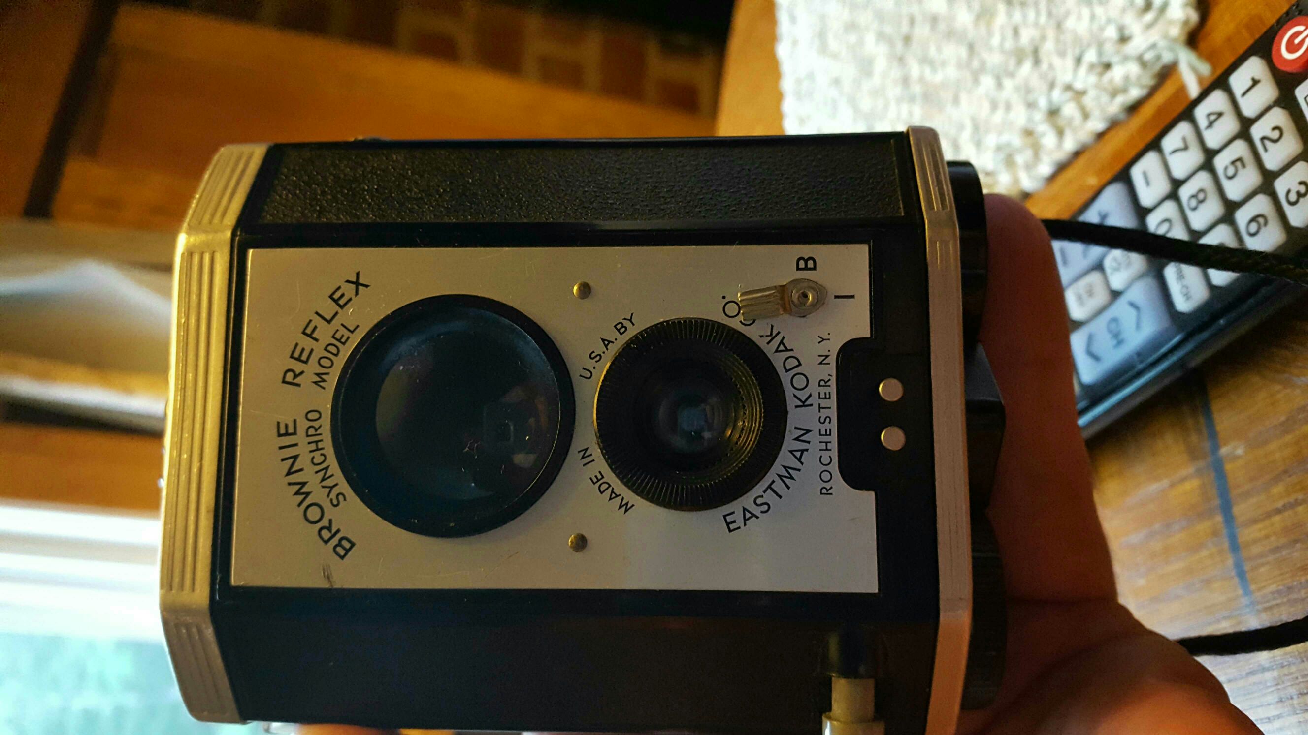

@vintagsnaps, I picked up yet his Brownie at the same shop for $5 and everything seems to be working. Just gotta get some film and start shooting
Sent from my SM-G920V using Tapatalk
Nice Find! According to this link you will need 127 film for that camera. Kodak has officially ceased production on their 127 variants but you can still get 400 speed from ilford and 100 speed from ReraPan. All things considered the rolls are pretty pricy (for what they are) however you can make your own 127 at home by either cutting down a 120 roll (much cheaper per roll, if you search youtube you can find some how-too's on it) or spooling some 35mm into paper (this will cause a crop factor but still work). Keep in mind you only have 3 pretty slow shutter speeds and a fixed aperture so I would start with 100 speed film if you are shooting in the daylight outdoors. Not all labs will develop 127 for you but you can run the black and white at home and most tanks will accept 127 size negatives.
If you are getting into old cameras its worth it to do some reading on film types and loading methods. I have considered buying some cameras only to find out the film is completely out of production and the cameras are useless as shooters.
