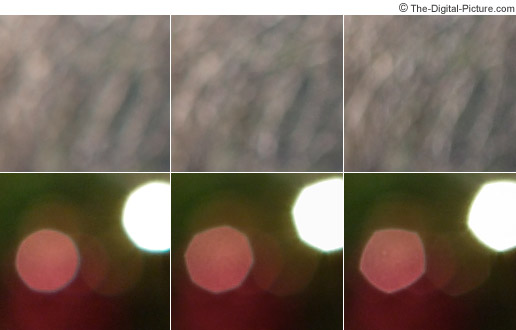

I wasn't talking about 35mm, I assumed she was using a 50mm 1.8 which doesn't create round bokehs, but more of a pentagon shaped bokeh (the one on the farthest right)
I was using the 50, and i think i got round bokeh.. Pretty sure, lol But now im gonna have to Zoom in and check it cuz its gonna bug me. The 50-1.8 doesnt create round bokeh, seriously though? Haaha
Wide open it should be round.
It's only when you stop down that the blades start changing the shape of it.
The number of blades, and the shape of them (straight or curved edges) will affect how round the bokeh is.
The 50mm 1.8 only has 5 blades, the 1.4 version has 8. Not only are there more, but their edges are curved, so that when it's stopped down it's still a little rounder than if they were straight.
I don't know if the blades on the 1.8 are straight or curved...
