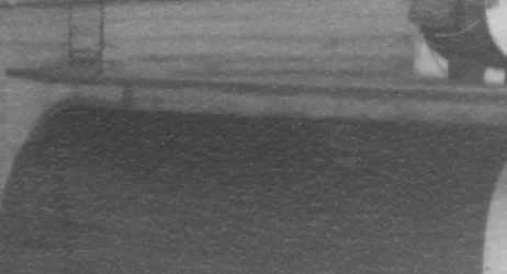

OK kids, I have another question that walks that fine line between digital and film...
Yesterday I spent time attempting to get a decent scan of a 100-or-so year old photograph, and no matter how I changed settings and messed with Paint Shop Pro filters/effects/adjustments, I just couldn't get a sharp scan.
Finally I looked closely at the photo itself and realized part of my problem was light from the scanner hitting the semi-flat surface texture of the photo itself.
Is there a way to prevent this "reflection"?
Any tips would be appreciated.
(see attached scan)

Only way around that is to shoot with a camera that has polarizing filter on the lens as well as a polarizing filters on the lights. You can dial out any reflections with the filter, this also works well for "silvered" prints, prints that have a very shinny glow to them.

Wish there was an easier way but so far nobody has come with a way to do it with a scanner. At the lab I work at we have all the stuff to do it, does make a few people mad because we charge twice as much to shoot in the studio than do a flatbed scan.

There is such a thing as dulling spray for reducing reflections. I have no experience using it for scanning prints so I don't guarantee it won't damage a 100 year old print. But, it is made to wipe off after use.
Or, you might try getting the print scanned at a professional lab
Is there any reason why you couldn't just put a polarizing film over the scanner bed and rest the photo on top?
Won't work. I've tried just about everything you can think of in my 35 years working in photo labs........
The only way to get rid of reflections, silvering etc. is to shoot it with 2 polarized studio lights each at a 45 degree angle and use a circular polarizer on the lens (camera can be film or digital).
