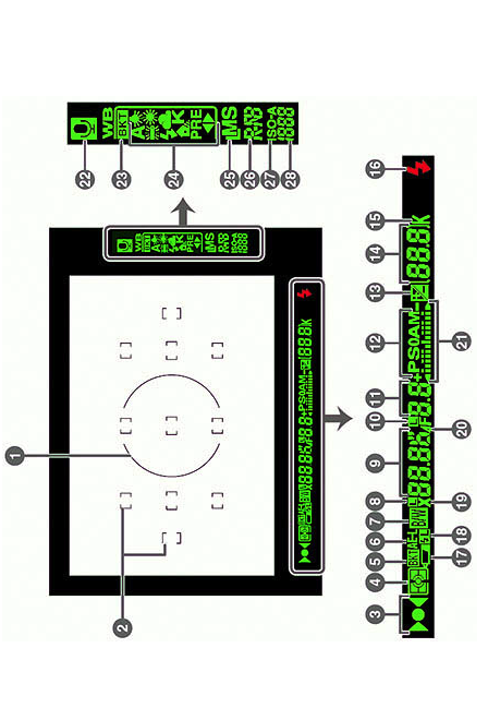

I own a D90 and have loved it since day one, but I tell you what, I'm finding the 11 point AF module to be a PIA in certain scenarios.
I had a Christmas shoot with a baby today (4 month) and I had a heck of a time with the speed and locking of the focal points. Not only that, but the placement often made it harder for me to get the composition I wanted, making me change something to get a good focus.
Not to mention that with dim light, if you aren't using the cross type point, you can get a lock and find it's actually off a bit when you review the image. I was shooting a low f/stop and found that the camera was missing by an inch or so (hitting nose vs Eye).

with the higher end nikons, it's only the center points that are X-type. Basically meaning you'd be in a similar situation anyway, just with more points to fish through.

Well...the D90 is a consumer body...the autofocus module in it is pretty weak compared against the professional NIkon bodies. Same with the Canon 5D...the AF module is, in a word, weak, compared with the pro-level Nikons. If you really want professional-level AF, you need a pro-level tool.
As Switch1FX mentioned, on the newer 51-point AF bodies, all the cross-type AF points are in the center of the frame. The old Nikon D2x and D2Xs bodies had 9 of 11 AF areas that were cross-type...that made portrait-mode AF even indoors in dim light very fast and precise, with the 1.5x sensor size giving the older D2x very good peripheral AF locations...the D2x was designed as a STUDIO camera...its AF in group dynamic or single-point is superb...due to the WIDE-area AF system and the placement of the points.
If you need a crop-body Nikon for studio/portraiture work, the D2x or D2Xs is a cheap alternative, and one that has a very strong AF module that just "works"...much,much,much better than say the 5D AF system...9 of 11 cross-type sensors works surprisingly well...Thom Hogan called it, "the focus anywhere system". Again, D2x or Xs bodies are low-priced these days....very affordable. It's not really how 'many' points a camera has, it is how well the entire AF system is designed, and how it actually functions. if you want a camera that can focus on OFF-center subjects, take a look at the D2x or D2Xs and how the AF system has been aranged,and its coverage of the frame, compared with the newer 51-point systems, which are much more centrally-weighted. Again, not a lot of people really understood it, but the D2x was really designed to be a STUDIO camera, best at ISO 100,and with a focusing system that's set up very well for portraiture, as well as shooting "talls" on moving subjects/action. It has a four-mode switch on the back,not three, not two..the system is a more-advanced, user-directed system that's designed for user configurability. The newer bodies are more for end-users,and are designed to have the camera track using RGB color and initial AF point selection and RGB and the Scene Recognition System sort of locking on via RGB color metering, and then tracking that RGB value as it moves across the frame.
