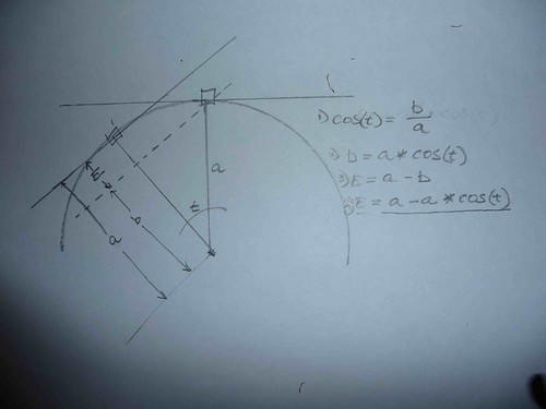

Seriously... leave it in the center. Then focus recompose and lean back for the shot. practice.. DOF extends further behind the focused plane than in front. No need to think of solving problems with more tools. Photogs been doing it for years before all this mumbo jumbo...
I still don't understand the lean back part.
Because your near limit of acceptable sharpness is less then your far limit. Meaning if you focus on an object you have less in focus area before that point, then you have after (more after). It's not a 50/50 split.
So if you lean back you pull that far limit towards you giving you a bit more "wiggle room". However, when you start getting some thin DOF, it really doesn't matter as you will miss focus doing this unless you are a calibrated robot with machine hands.
This is my understanding...
P1020064a by usayit_2000, on Flickr
THe actual focus plane falls behind the original subject. I ran some numbers and E is less than what most people initial believe (see previous thread I posted a link to)... Since leaning isn't an exact measurement, the fact that there is more DOF behind a subject (as Dominantly mentions in previous post) actually works in your favor.
There are dozens of techniques... This is one that was just taught to me and I adopted.. got used to it. I do this with 50mm @ f/1 quite often.
