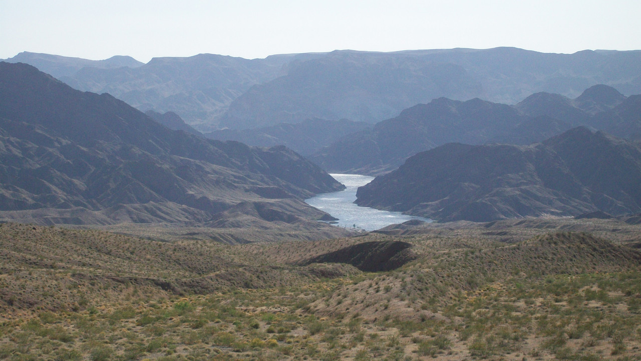

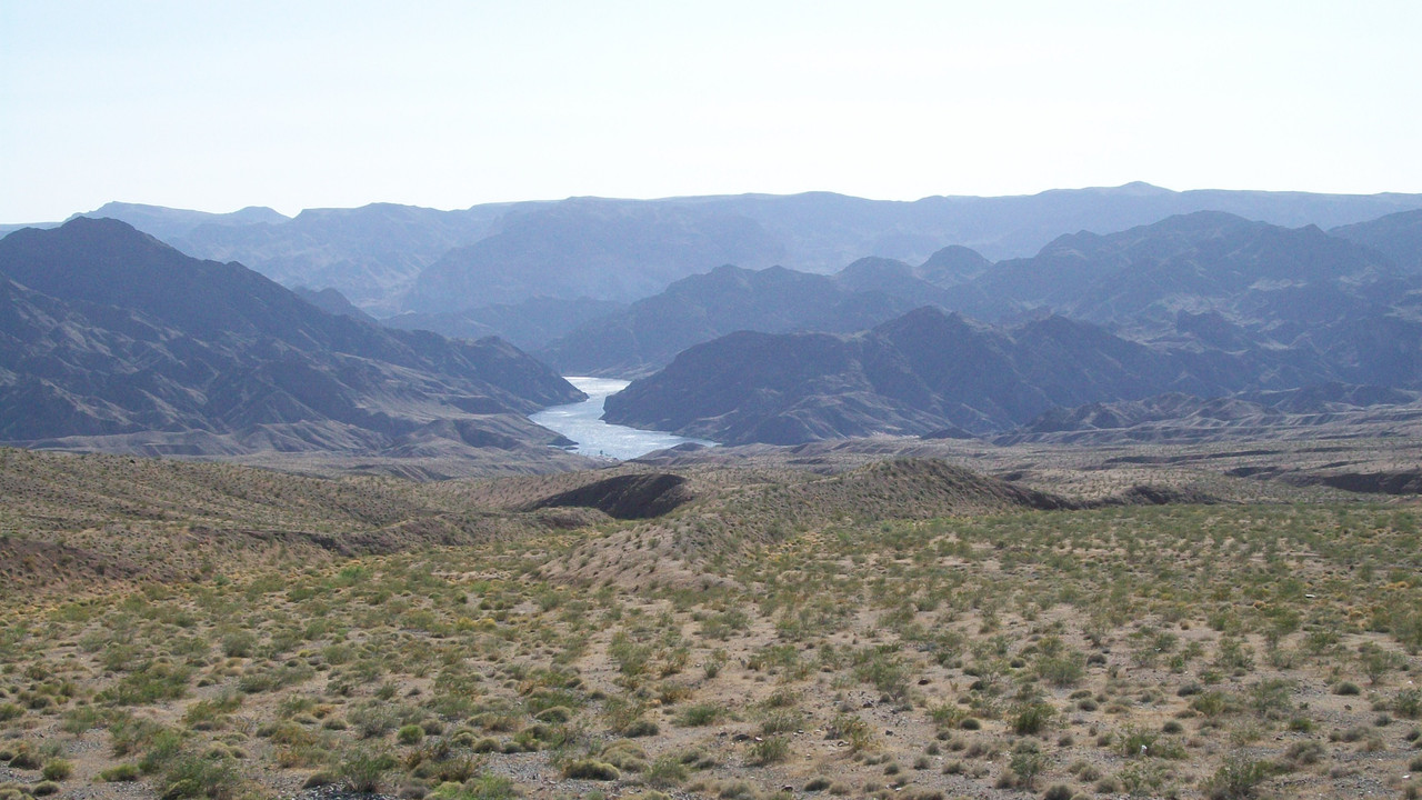

I went through some pics I shot some years ago heading back to Phoenix from Las Vegas .
These were taken at an observation area on I93 southbound from Nevada on the way to Kingman, AZ. It overlooks Willow Beach in the Black Canyon area of the Colorado River.
The first one I was ok with, as I actually wanted the "beach" area (i.e. the small-ish foothills with clumps of grass in the foreground), but like with the other pics the canyon in the distance wasn't as large as what my eyes were observing. I took a second shot which was closer to what my eyes could see, but I lost part of the foreground in the process. So it seems that in order to get the mountains in the distance to appear the correct height, I'm going to potentially lose the foreground by effectively "looking past" it?
