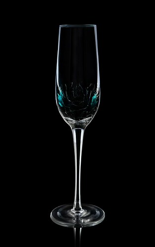

another trick I've tried, if it's big enough, is using a light box. Mine's 36"x36" so I can use that to diffuse light fairly well--even if you want to shoot on black:
Blue Champagne Flute 4 by The Braineack, on Flickr
I did this inside my lightbox. The black bg is a strip of velvet that was just wide enough to fill the frame. That gave me the nice even highlights/reflections on the sides/stem.

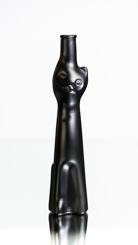

But remember: It's not the size of your lightbox, but the cat inside:
