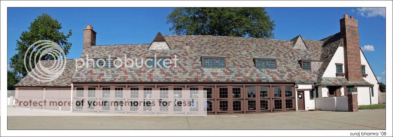

example: i was really happy with the skies in this pano i did

Easy. In the first picture you're exposing for the highlights. The white part of the building on the right is well exposed and thus much brighter than the dark blue sky.
In the second picture you're exposing for the shadows. The cars are in the shade and simply sooo much darker than the sky so the sky will blow out. There's only so much dynamic range you can capture on a digital sensor and unfortunately it's less than half of the capabilities of the human eye.
Up the ND grad to 4 stops or more, and or do multiple exposures one dark enough to get the sky blue and combine them in photoshop or HDR them.
