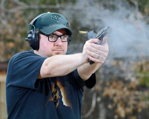

Anyhoo..... I WAS able to make it to the range today, and since myself and a friend were the only ones there, it was really overcast, so there was no overbearing light from our friend the sun...I didn't feel bad turning the range into my own personal studio.
Here are a couple that I was able to pull off..... well technically my buddy was pressing the button on the remote, but I'm the one that set up the shot.... so I guess they are still my pictures.
Here is the setup. D7000, Manual focus 135mm AI 2.8, SB-600 and SB-27 I put the camera in manual, f/5.6 (for desired DOF) and 1/100, since that is what the meter in the camera tole me was the "correct" setting for the ambient light. Then I seu up two bare speedlights. Rigged the whole thing with radio triggers and a wireless shutter release (don't want to be standing in frong of the firing line, now do we?) And voila! I had a stand in for focusing, stood in the same spot, and on the count of three, my buddy pushed the button and I pulled the tigger.
I'm pretty thrilled that the focus is spot on, and after playing with the lights a bit, I think I found a good combo.
Let me know what you think!
ETA, Link to full size http://www.flickr.com/photos/61095014@N03/5604886218/sizes/l/in/photostream/
Where were your lights? Just a guess, but if it was overcast like you say, it looks like your flashes are overpowering the ambient as you're getting a harsh shadow from them. Is that what you were aiming for?
yes, your shadows are very harsh from the flashes... try moving them back or turning doooooown the power fo sho
No, not really what I was going for, but I'm still pretty happy with the pic overall......Yeah in hindsight, they were a bit too bright, it's really hard to tell on a 3" screen on the fly....... Need to be turned down, but a good experience none the less.

Like the others I think that you may have the flashes a bit too hot for bare heads, which is giving you those shadows and probably a blue hue to your skin. I'd gray card from the line with the flashed turned down a bit, and I'd probably put one high and one low.

The shadows look rather flat. I maybe wrong but did you have the two flashes one on camera right and the other on camera left(maybe equally powered or equidistant)?. Looks like there are some shadow cancellations creating that flat look. I suggest practice with one flash first and study how the different flash positions create certain shadows, certain looks. It really is amazing what one flash can do.

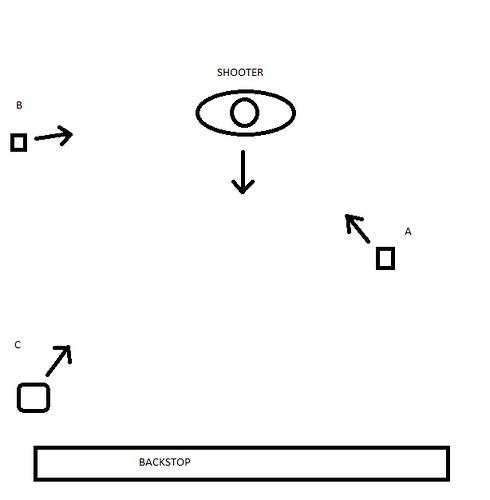

So for those of you who were asking about my light placement, I have constructed this crude thirdgraderesque diagram showing the placement o the lights. A was my key, about 6 ft from the subject at 1/1 power. B is the second, also about 6 ft at 1/2 power.

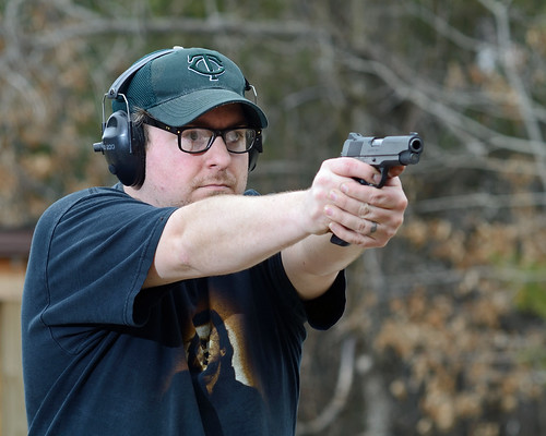

I have also looked through the pics again, and found one that was taken before the key was recycled, so you can see that the "fill" was not as bright. (added below). My overall goal with this one was to get catchlights from A just above the pupil, but none from B. Also to get good lighting.... which it seems I went a little too much. Next time I go out, I will cut the flash power by half, and if it's not windy use a couple umbrellas (the reason I didn't use any yesterday.... those things are like sails :lol: )

Hre is the diagram... \
Here is the other pic..
