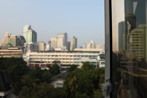

At f8 out of my window
IMG_1841 by SpeciesHuman, on Flickr

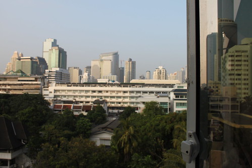

At f3.5 out of my window
IMG_1840 by SpeciesHuman, on Flickr
Both 'beep in focus'

The second shot looks like it focused on the glass..

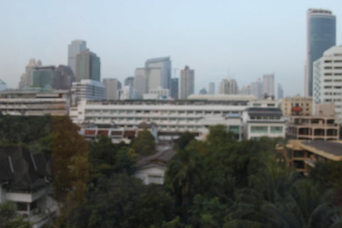

This is at f3.5 spot focused to the buildings in the distance. They are out of focus and the window frame is a lot more in focus!
IMG_1842 by SpeciesHuman, on Flickr
This is at f8 again spot focusing in the distance
IMG_1843 by SpeciesHuman, on Flickr
And just to show it isn't the glass! (With the window open at f3.5)
IMG_1845 by SpeciesHuman, on Flickr

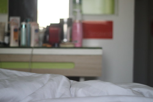

Here is me focusing on the pink bottle at f1.8 with the top focus point (as you can see it ends up focusing on the bed)
IMG_1848 by SpeciesHuman, on Flickr

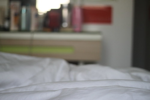

Here is me focusing on the bedside edge of the bed sheets at f1.8 with the bottom focus point.
IMG_1849 by SpeciesHuman, on Flickr
