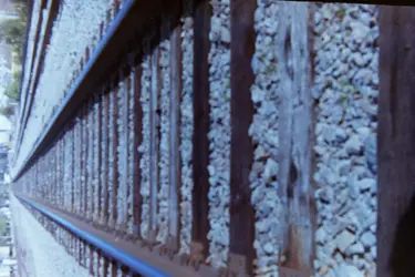

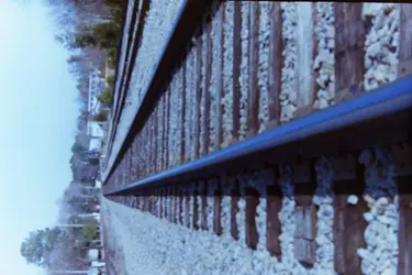

Here are some photos from the last roll of film I took with the camera. I tried uploading photos of the lens, but the file was too large. I will try again later. The focus at infinity is aligned perfectly, yet the photos still turned out blurry. Is there any other reason for blurry photos besides just the RF? $PICT0068.webp$PICT0069.webp

1) What lens are you using?
2) Where did you focus in the sample pictures?
If the lens distance scale and RF agree at infinity, it could be that the lens is off. Russian lenses are not as standardized as others, and often need to be adjusted for an individual camera.
You need to test the lens on the camera with a ruler or something that allows judgement of the focus error.

I found out that the lens didn't match the camera body. The lens is actually older than the body, so I had it sent off to someone that deals with Russian cameras. He should be able to calibrate the lens to the camera body. The sample photos came from a roll that I put through the camera a few days ago. I used your technique, and there was a focusing error. Fixing it is a bit out of my realm of knowledge, so I'm just sending it off to a repair guy. This will also make sure everything else on the camera is working right
