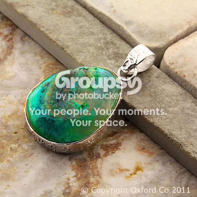

I am new at taking photo of jewelry. I have a Canon T2i Rebel with a 60mm Macro Lens and a Digital Lighting System.
I also process my photos in Adobe Photoshop cs2
Here is an example of what I am getting. I use ISO 800 Custom White Balance F16 Shutter speed 50-100
http://d3d71ba2asa5oz.cloudfront.net/32001225/images/pendant941__1.jpg
http://d3d71ba2asa5oz.cloudfront.net/32001225/images/pendant1809__1.jpg
But I am trying to reach a level of photography such as the images below.
I do not know what i am doing wrong. I can't seem to get the brightness and depth of field and crispness of these photos below.
What am I doing wrong or what are they doing right! PLEASE HELP!

Your key problem is 100% the lighting alone (along with some minor corrections needed to camera settings). However first what exactly is your Digital Lighting setup?
Hey Newbie,
Good news is, your pictures are good to start with. Nice lighting and composition. And you also have the correct tools to make good pictures great. All you need is some white balance and level adjustments for contrast.
In Photoshop this was a 2 step process per picture
1) Do a Shift+CTRL+B for Auto color correction (Photoshop did a pretty good job with Auto on your picture)
2) Do a CTRL+L to bring up "Levels" Simply drag the black slider in until you like the looks of Blacks and color, drag the white slider in until you like the hightlights
As seen in the picture below, just a little move of the sliders made a big difference!

Use a tripod. Your subject isn't moving so you can use a much slower shutter speed. I too was wondering about your lighting setup, because that is part of the issue.
Lower your ISO to ISO 100, that's 3 stops less light sensitivity from ISO 800, and less chance of image noise. Your lens aperture of f/16 is to small a lens opening for what you are shooting. Open the aperture wider to f/8 (that's 2 stops more light)
Use a 1 or 2 stops longer shutter speed for more light (1/50 - 1/25 - 1/10). The 2 stop change of aperture and the 1 stop change of shutter speed balance against the 3 stop change in ISO.
Your first photo is under exposed. Learn how to use the historgram that can be displayed on the rear LCD of your camera.
Here is a small group of tutorial: Tones & Contrast
I would also use a mask and adjustment layer on the whites so you don't loose detail in them

Personally, I love your background; the texture of the stone makes a very nice background for the colorful jewelry.
I agree with those that they just need some saturation and level adjustments to really make them pop. I love the versions that philsphoto came up with--in fact, I like them *better* than the ones you posted as what you're aiming for. IMO, the two photos you indicated as your "ideal" are so saturated that the orange "stick" stands out more than the jewelry. I like your background much better.
I agree completely with sm4him, don't change a thing on the back ground! I loved the color, texture, repeating lines and the geometry! It works well! If you have the skills to mask a layer, it is easy to do. Overall, I think your photos are great, they just need color correction and a contrast punch.

I think the color correction is a huge thing, but I also think you're using a flash or too much light because some of the metal is blown out. I would use a tripod like someone else suggested, then you can also use a ISO 100.

I am using a light box made by mk digital... http://www.mkdigitaldirect.com/images/mk-boxes/productphotos/ebox/main-Photo-eBox.png
I do not mind the comments about background I would rather have an honest opinion from everyone.. so thank you for your honesty. :D
I also have a tripod. I am also resizing the image as "save for web" I dont know if this takes away from my resolution.
I am also putting desk lamps with flourescent light bulbs and covered with a mesh fabric sort of like the type found on a light tent.
I don't seem to be getting the depth of field as found in the "ideal photos" His pieces look like someone can reach out and grab them.

hows about opening the aperture up to about 5.6 instead of 16. Your shooting super close. You do not need such a large DOF. You dont need better lighting you just need to let more light in your lens.
As for background just use a white table cloth.
