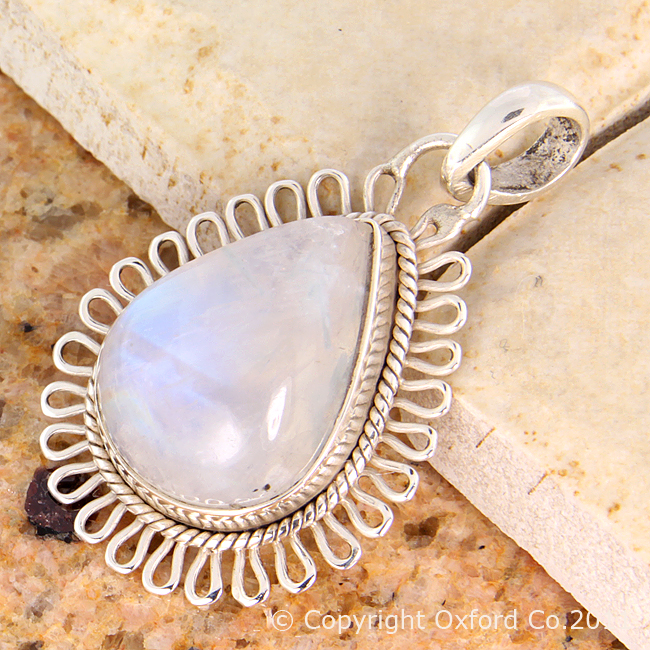

help! Cant get my photos right! Any help all help appreciated!
Ok, here is an edit where I used a layer mask to maintain the available detail on the clasp part. I agree that this area is already blown out. Shooting in raw would help too. I also boosted saturation a bit.
pendant941_edit by Phil's Photography, on Flickr
http://d3d71ba2asa5oz.cloudfront.net/32001225/images/purplering.jpg
here is the best un edited photo i could get this afternoon . here are the specs of the picture
now what should be done to the photo to get it perfect?

Where's Bitter when you need him. lol

Metering Mode Evaluative Metering .......................Use Spot metering mode instead
ISO Speed 400 ......................................................Use ISO 100

Sharpness 3 ....................................................... Set it to zero

Auto Lighting Optimizer 2:Strong .....................................Turn it off.
Peripheral illumination correction Enable.............................Turn it off.

Usind Evaluative metering diminishes the effectiveness of your lighting and is contributing to your blown highlights.
You can turn the ISO down and make the shutter speed shorter to compensate.
Sharpen locally, and more precisely post process, rather than sharpening globally with the crude in-camera settings.
For the Last 2 settings I highlighted, again, the in-camera controls are crude, and the camera has no clue what you are making an image of, or what your image goals are.
The standard approach is to put the jewellry on a light box and shoot it through a reflective dome.
