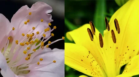

Not to belabor the point, but frankly I've never found a situation where I couldn't use a monopod or tripod. It's kinda essential if you want to do macro. Here's a quick close up comparison of your blossom and a similar flower shot I took.
Notice the detail comparison on the anther? Your aperture was f/16. mine was f/3.5. It's about stability and managing your DOF.
