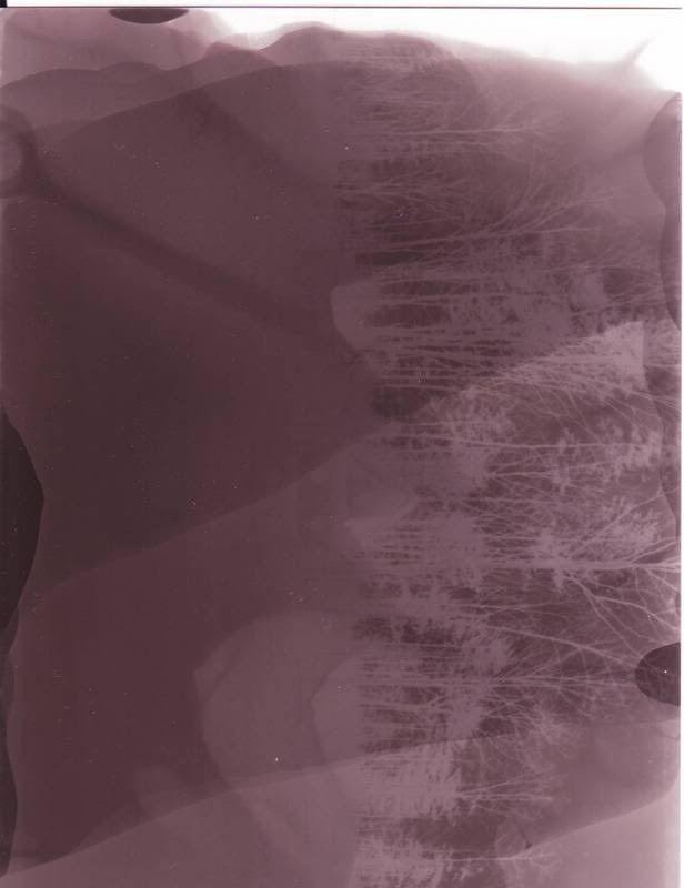

Hi-
My daughter is trying her hand at pinhole photography for the first time, and we're running into some problems with the developing. She did a mini-class last year, so she knows what they should look like. (she's 14)
This is our first time at developing our own photos. She used the oatmeal box design for the camera, which she and my husband put together. She's using the resin-coated paper film.
She's experimented with different exposure times, but every time we put it in the developer, it just develops into a smeary mess (different every time). We're using Ilford paper developer (liquid concentrated), which we mixed with water according to the directions.
What could cause this? There are black and dark gray smears, and very little of the image. What we can see of the image (if anything), has pretty much no contrast.
Any advice would be greatly appreciated!
Thanks-
Theresa

The camera was definitely still (sitting on top of our septic field cover with a map weight on top), and as far as I could tell, the paper was loaded correctly. It's not a blurring of the image, but big streaks. You can't really see the image at all.
I scanned the photos (if you can call them that!)

Here they are.....
Any ideas?
http://i113.photobucket.com/albums/n226/theres126/pinhole1.jpg
http://i113.photobucket.com/albums/n226/theres126/pinhole2.jpg

how long do you develop, stop, fix, and wash?
i think it might be chemical stains.
This comes up in the developer - and fast!
We develop only about 10-15 seconds, or so. Once the color starts appearing in these patterns, we pull it out.
The stop bath is about 10 seconds, the fixer, two minutes.
But, like I said, it already looks like this when it comes out of the developer....:(
Could the developer be bad? (we just bought it). Could it be mixed wrong? We did follow the proportions on the bottle.

i see, the only other thing i can think of that looks like that...is fogged paper.
was the paper exposed to ANY light other than the red/amber safelight before being "shot" in the pinhole?
No it wasn't.
We opened the package with only the safelight (and it was new, when we opened it)
It's frustrating, since my daughter is trying to use this as a project to get her into Governors school at her high school. She took a course at a summer enrichment camp where they did the pinhole photography, and developed their own pictures, and they looked great. She loved it, and wants to continue it on her own..... We're not sure what went wrong, or where to go from here!
