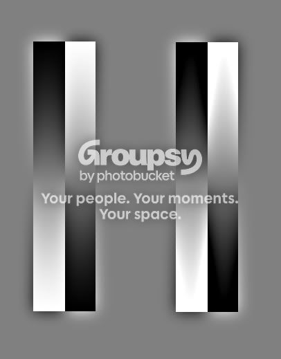

Now there's something that I haven't through of. What is the difference? I went a head and did a quick test to see how each reacts in photoshop by way over applying them to gradients. Check it out:
On the left is High pass with a radius of 10, and overlay with a 100% opacity.
On the right is unsharp mask with a radius of 10, tolerance of 0 and 100% strength.
Now a quick analysis shows that on the outside edge the effect looks incredibly similar, actually if I removed the centre you wouldn't tell the two effects apart when they spread out onto a solid colour. This result would actually favour the unsharp mask since it is far more configurable. You can have strengths greater than 100% and the threshold to limit the effect slightly. This however can also lead to abuse and unfortunately over sharpening and ugly halos. The upper limit on the effect of highpass/overlay may drastically reduce the chance of this oversharpening unless it's applied several times repeatedly.
One thing I am surprised about is that the inside of the gradients appear much smoother on the high-pass filter. This would tend itself to a more linear effect against varying contrasts, however that would lead to a reduced "perceived" sharpness.
Now just not looking at images yet I would say from this that high pass / overlay would be incredibly well suited for really large scale sharpening to increase local contrast, such as a radius of about 150pixels and an opacity of about 30% or so just to give the image a little more pop since the results would seem to be more linear and consistent. I'll have to try this at some point since I've previously used unsharp mask for this purpose.
That said for final sharpening and creating more edge definition the more aggressive application of the unsharp mask may favour more. I would imagine it would give a "sharper" effect at a lower radius, along with it's customisability it would best suit the actual overall sharpening of the image to increase the microfine detail.

Hate to reply to an old thread, but I put your clever little test image to good use.
And I can now answer the question of how HighPass sharpening differs from USM. They both start off the same way: by subtracting a Gaussian blurred version from the original. But the USM adds the difference directly back to the original, whereas the High Pass sharpen has to use a blend mode to do the work—and the formulas are not the same.
You can view all the gory detail in my paper at
http://freixas.deviantart.com/gallery/#/d2rib58
