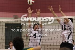

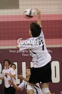

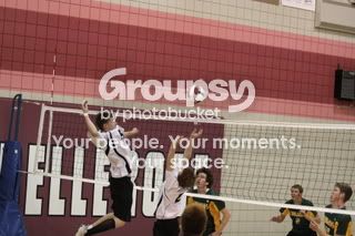

They asked me to do some of the senior men's volleyball team shots and I was worried at first because it was my second time using the big lens and my first time actually shooting sports with it. I think they turned out ok for a first time. Any suggestions for the future based on these? I picked my four favourites:

when im shooting volleyball i usually always try and get the gym floor and their feet. It helps put into perspective the height of the jumps
The 70-200 is a bit long do they have a 50F1.4 you could try
What camera are using? The shutter speed seem a little slow. You may want to try upping both the shutter and ISO. I also think that more practice will help with the framing. Are there any bleachers or a spot you can shot down from in gym? Bit of height would help with #3 so you could see the player face coming up/over of the net
I shoot high school sports nearly every day and volleyball is by far the hardest. You did pretty well for your first time. I know 30 year vets who still have trouble with volleyball.
Using the long lens is perfect. I use a Nikon 80-200. And you're not gonna stop the action completely inside most high school gyms(they are typically not well lit). It's just not going to happen unless you're shooting a 3200 or higher, and most cameras don't perform well at that high an ISO. The images start looking soft even with the best high ISO bodies like the D3/300. Showing the ground is also not necessary unless you are high up and shooting down on the players so you show the ground beneath them. If you zoom out enough to show the floor when you are on the same level as the players then you are going to lose facial expressions and there will be a lot of dead space in the shot around the player. And my final advice is try to get up high enough so your lens is about halfway up the net to get face through the net. And stand near the center of the end of the court(pretty far back from the court though-don't want to be too close) if you want good net shots. This will get you clear faces and avoid the angled net in the shot. Obviously if you want shots of the players digging down the you'll have to get low to the ground.

Certainly a good start, I can imagine that Volleyball is rather hard to shoot.
u had a 200mm and thats how far you were? seems like you could have gotten a lot closer
All but the last one were 70mm or 110mm.
Good job with what you had to work with, but you need to work on composition. Practice, practice, practice. These have promise, and keep your hands on that lens and see how much you can use it.
