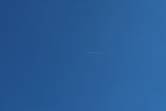

How can I tell where dust is at?
Yes but how can one tell the difference between sensor dust and dust on the body side of the lens? I'm sure dust on the body side of the lens shows up on a photo too right ?
Not unless it's a very heavy deposit of dust. Specks of dust will normally not show up on a photograph. That's why every keeps telling you that it's sensor dust. Dust on the sensor (actually the filter array but it's part of the sensor assembly) most assuredly will show up, and it will show up exactly as is seen in your photograph.
To look for dust on the rear objective lens, just remove the lens and look. To look for dust on the front objective, just look at the end of the lens. It really is that simple. If you don't see any dust there then there is no dust there.
You need to spend some time gaining a better understanding of how your camera works.
One of the side benefits to researching and finding the answers to your questions on your own, is that you find out what you don't know, you don't know. ;)
Dust that is not in the path of the light between the subject and the sensor CANNOT show up on the image.
Dust on the mirror, focus screen, prism, viewfinder, on the camera body, in the battery chamber, on your glasses, etc. will not appear on the image.
I think a very basic step should be mentioned... Switch lenses, if the same spot is still there you know for sure it's the sensor. I highly recommend you use products designed to clean the sensor. Using something like a q-tip is likely going to just move dust around and maybe deposit lint on the sensor.
This was done at f32.

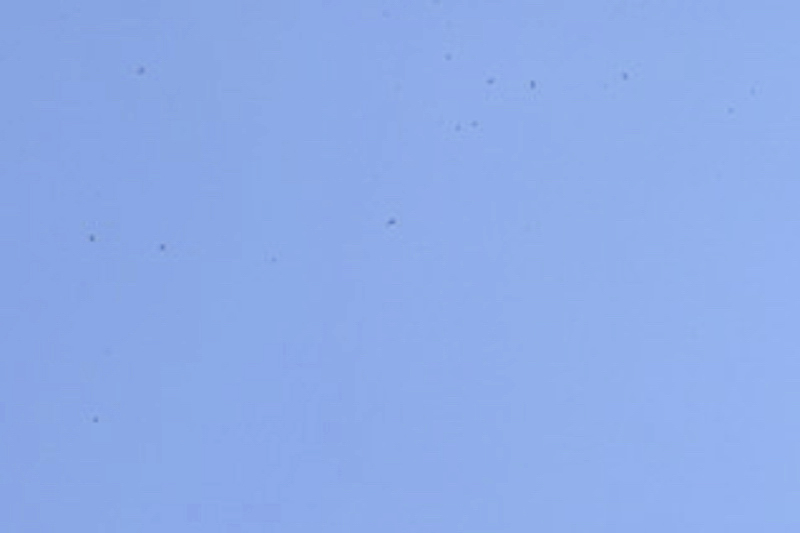

And you've got dust all over your sensor. This is the upper left corner of that image at 238% magnification:
All of those black dots are dust on the sensor. I only cropped out a piece of the image but the rest of it is much the same.
