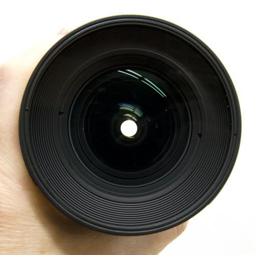

I'll assume that you do indeed understand the concept and properties of the entrance pupil. Here are two snaps that illustrate the experiment I wanted you to do. The lens is a 24 mm f/3.5, wide open, with a filter fitted to the front. The first picture is taken on axis and the second off axis. Hopefully you can see that the entrance pupil (and hence the zone through which the light rays that form the image pass) is in different locations at the plane of the filter. If you do understand what the entrance pupil is, you should now understand that the light from an object point that will subsequently form the image of that point does not pass through the whole of the filter, only a part of it (because the filter and the entrance pupil are not in the same plane).

I can see the bright opening do not appear to align with center of the front lens element in the second picture. Interesting, but is it relevant? Regardless the reflections of the lights behind me in the room looked pretty.
Of course it is entirely relevant. You don't understand the concept of the entrance pupil, do you?

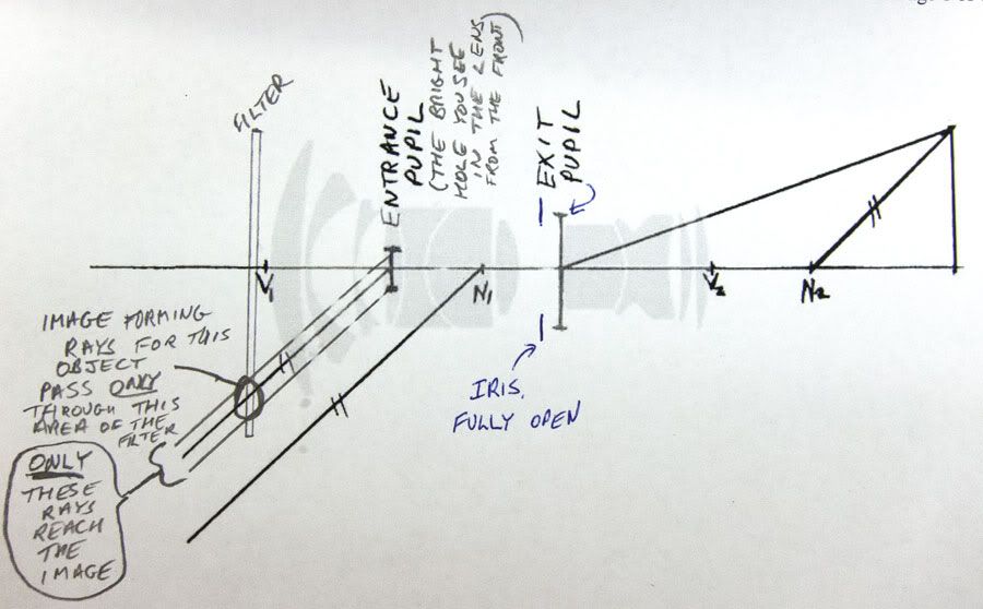

The filter is not in the plane of the iris
(which appears as the entrance pupil). The entrance pupil of a compound (ie multi-element) lens is not usually at the front element as it is with a simple single-element thin lens. Forget the thin lens diagrams and look at the ray diagram of the compound lens I posted earlier.
Here's the amended ray diagram. Sorry I haven't got a scanner handy - this is a quick picture with a P&S.
The entrance pupil is the image of the iris (wide open here) as seen from the front of the lens. In my pictures of the actual lens it is the bright white dot. Only rays that are heading towards the entrance pupil get through the lens to form the image. If a ray is not headed towards the entrance pupil, it will not reach the image. Therefore this diagram shows that not all the rays from an object point that reach the filter will then reach the image.

The light doesn't get mixed up to a single ray (of course) but in a properly designed lens all the light that forms the image is 'mixed up' evenly at the iris. This is a necessary condition for the iris action to affect the brightness of all parts of the image evenly. (The effect may not be perfectly even when the iris is wide open or close to wide open.) By 'mixed up' I mean that the light from every object point that is imaged is spread evenly across the whole of the iris. Therefore an ND grad at that location, or close to it, would have no graduated effect, exactly as hertz points out (it's very clear that this is the case that hertz is locked into thinking about, even though hertz might not yet realise it). For a simple, thin lens the aperture stop (iris, diaphragm) can be very close to the location of a filter.

Because if they aren't heading towards the entrance pupil (the image of the aperture stop as seen from the front of the lens) before they enter the lens they will not make it through the aperture stop itself. The WHY is very simple once you understand what the entrance pupil is, which you don't appear to have done yet.
Please think about what it means for the entrance pupil to be the image of the aperture stop. A ray headed towards the edge of the entrance pupil will be bent once it enters the lens, so that it then grazes the edge of the aperture stop. We see the ray that comes the other way - a ray coming from the edge of the aperture stop comes out of the lens towards us along the same path, then emerges from the lens towards our eye. It appears to come from the image of the edge of the aperture stop, ie the edge of the entrance pupil.
