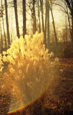

Backlit image of coarse. Probably partial metering off of the back of her head. That looks like real lens flare though. Tones look realistic to prime time golden hour with a vibrance bump.
"Veiling flare" will brighten shadows in images like this.

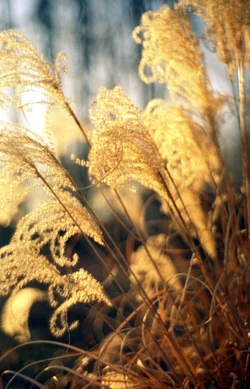

"Test images", Jupiter-3 5cm F1.5 on a Contax II.
