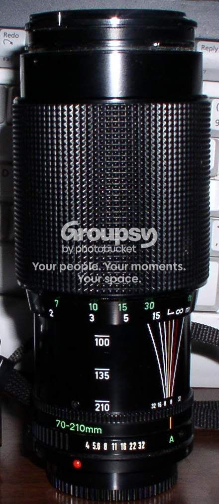

This may be a dumb question but here goes. How much zoom does a 70-210 mm lens have? its not written on the lens and I cant find any info on it?
here is a quick pic
210/70=3 3X Is that what your after?
it must have a higher zoom than that... i have a digi cam (Olympus C-4000 Zoom) and it has 3x zoom and i can get in WAY closer with this lens...
That is how it is worked out. Your 3x zoom on your Olympus is 35-105mm.
Don't forget, your Olympus is 4.1MP so the picture is pretty big. You could be getting a false impression. Because the image is nice and big you can crop it so that it looks like you have a big zoom.

70-210 will be about 1.5 - 4x magnification. The general rule is 1x magnification for each 50mm. Your digital is 3x magnification for its widest point. Most likely a 40-120mm zoom. Or something close to it.
It's confusing because we're talking 2 different things:
The zoom range is 3X (210/70).
The magnification factor, at 210mm, is 4.2X (210/50mm, a standard lens).
However, a digital camera usually has a focal length maginifaction factor depending on the sensor size, probably 1.5 or 1.6, so a 70-210 zoom is really like a 105/315mm, so the zoom range will still be 3X, but the magnification factor will jump up to about 6X.
